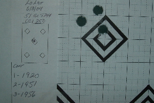

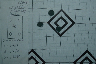

Anyway, not having been able to get to the range since March, I couldn't stand it anymore and took Wednesday afternoon off from work.  This range trip was primarily to do the things we'd talked about it the previous thread; confirm velocities and compare standard and magnum primers.
Well, it was about 88 degrees, not much wind to speak of and I had the range to myself!  Just the way I like it!   ;D  The loads were 50 and 51 gr. of 5744, everything the same except 6 were loaded with CCI LR Magnum primers and 6 with Federal 210 LR's.  The velocities conformed to the last trip's average so the first rounds must have been an aboration.
Here's the targets for the 51gr loads.
You can see that there is little difference between the 2 primers.  The mag's targets with both charges says they're a little faster and group a bit better, but that could be caused by a number of factors other then the primers!   :-\
One thing is sure, that rifle can shoot!   LongTom, I think the original owner of that barrel was a little off when he said it wouldn't shoot jacketed bullets!   ;D
Now, I know a 1900 + fps 405 gr bullet load ain't much by Tim or Tyler's standards,  :-[  but I have 3 other rifles to get ready for deer season and this appears to be a reasonably accurate and mild recoiling load.  So I guess it will have to do for the time being...  8).
However, I will still play around with some 350 gr. loads as magnum primer availability permits!   ;)

Looks like some damn fine loads to me.  Glad yer back on line, Richard.  DP

t appears that both rounds will be minute of deers heart to me. How many yards were you shooting at?

The 405 grain bullets will probably perform much better at your velocity!  Yes, what yardage?

100 yards.  During load development I always shoot at 100.   ;) :)
