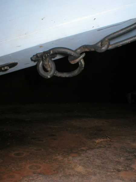

« Reply #15 on: December 12, 2008, 06:17:28 AM »
anchor point under trail with a hand forged hook on a ring.

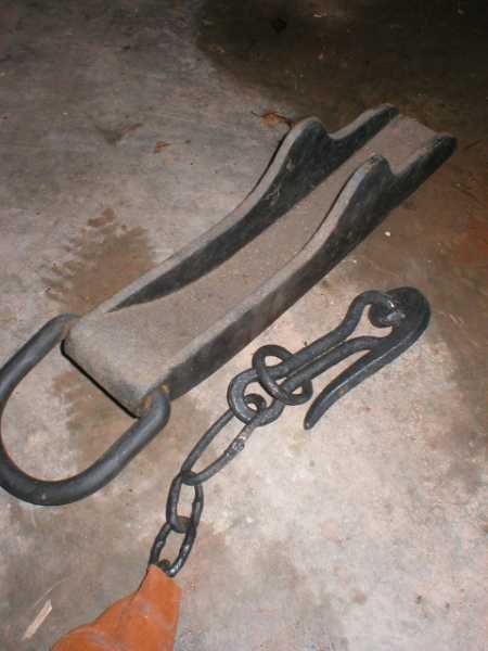

« Reply #16 on: December 12, 2008, 06:21:12 AM »
The other end where the latch secures to the ring.

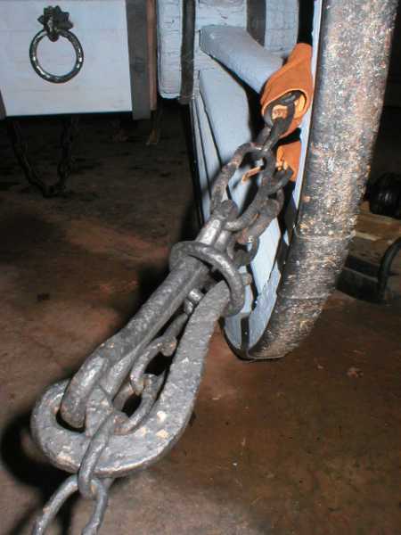

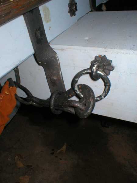

« Reply #17 on: December 12, 2008, 06:30:10 AM »
Take out all of the slack after looping the chain around the spoke from the inside of the wheel.  Keep your spoke contact point in a direct line and the shortest distance to the trail anchor point. The chain snugs up when the catch lever is fed towards the ring.  I made a leather sleeve for the chain's contact point, to protect the wood and paint a bit.
