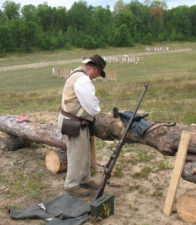

Is this the gun you are talking about?

Whitworth made a hex bored wall gun for Indian service in 1866 which had a removable breechblock. It was mounted on a yoke with pin. Artillerman fired one in a long range match several years ago.

Artilleryman,
What is the caliber of your Whitworth?

« Reply #9 on: May 10, 2011, 03:01:13 AM »
REAL close!!!...slight differences.....wow.......i'm hooked!

Offline Artilleryman
  • Posts: 1378
Re: wall-gun question
« Reply #10 on: May 10, 2011, 12:02:59 PM »
Artilleryman,
I was told that it is .75 caliber.  I have used .69 caliber rounds in it, and they seem to fit.  I think it depends on how you measure the bore, across the flats or across the "grooves".

Though Norm shot .69's , the gun was designed to shoot a projectile. Molds for most of the non standard calibers are hard to come by.

Thanks, Artilleryman and guardsgunner; I'd read of the famed accuracy of the Whitworth .45 caliber Sharpshooter that some CSA snipers used in the CW, but I knew nothing about Whitworth's larger bore breech loader.
