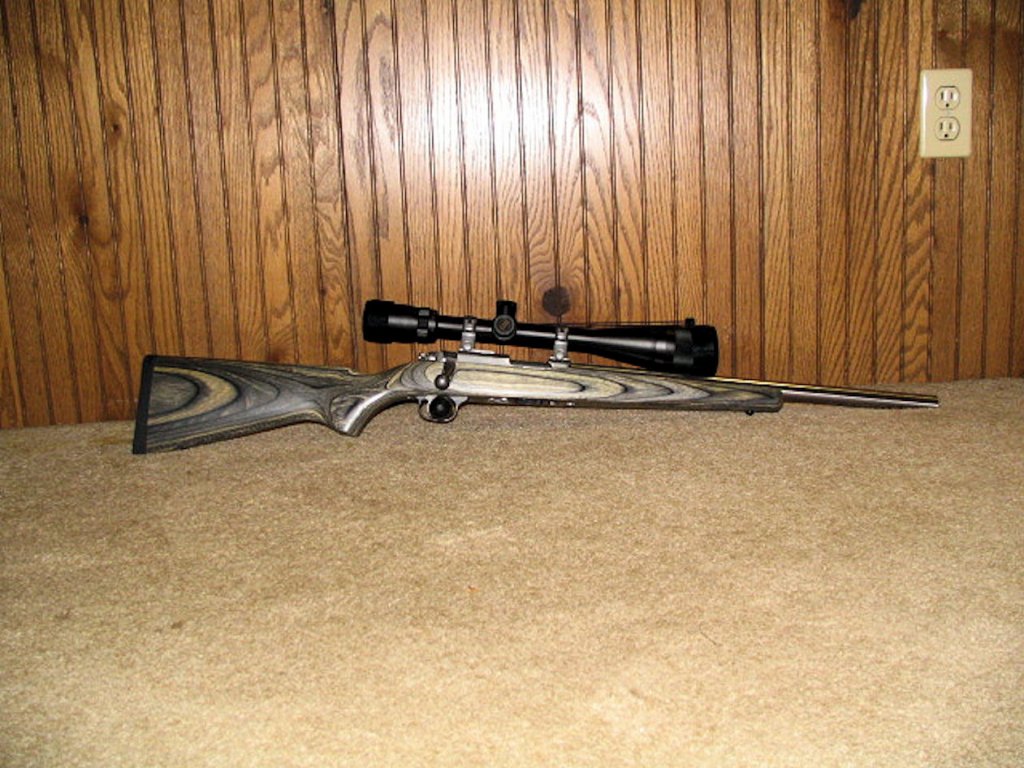

There was a thread started about what 17 HMR bolt action do you like most a while back. It got a lot of reads and comments. The Ruger 77/17 got a few comments, but there were some that talked about CZ's, Marlins, Savages, etc. I can not talk about the other rifles. They may be great, but I do not think they could be any better than the Ruger I have and most probably not as good. I have a Ruger 77/17 that I have modified some what. I put on a Volquartsen barrel and a Timney trigger sear. I know it is not stock, but the Ruger is easily modified, while most of the others are not. I just wanted to show you what the potential of the Ruger is and the 17 HMR. Here is picture of the Ruger.

The purpose of this thread was to start a discussion about the 17 HMR accuracy and about the accuracy potential of the Ruger 77/17. I just want to discuss the merits of different guns in the 17 HMR. I do not want to start a war, just some discussion among fellow shooters. I made some bold statements, but that was just to start a discussion. In the end we all have preferences. It is a good thing we do not all like the same thing, other wise there would be a lot of gun companies out of business. I have heard so many that say the Ruger will not shoot well or making IMHO wild claims about accuracy of their guns. I have nothing against other types of guns and I really like the looks and feel of the CZ (except that stamped trigger guard). I own a Marlin 22 Mag and I like it just fine, but it will not hold a candle to this gun in the accuracy department. My Ruger weighs a little more than it did with the stock barrel, but mine was the heavy barreled one to start with and this barrel is shorter - 18.5".

I can highly recommend the Volquartsen barrels. When you install them, they are driven into the receiver. They fit tight, so there will be no play between the barrel and the receiver. It just depends on what you are looking for accuracy wise. I am not positive on this, but I think you can get a carbon wrapped barrel, that is much lighter. Do not know how they would shoot, mine is a Stainless barrel of .920" diameter X 18.5" length. The 18.5" length is supposed to be the ideal length for highest velocity.
