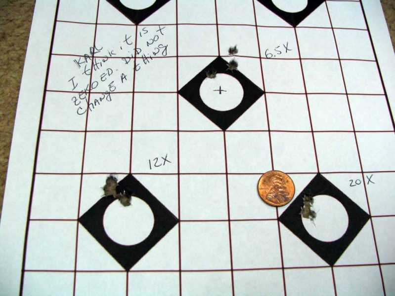

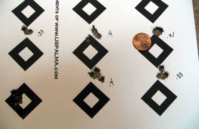

I am a believer in lower powered scopes. On a solid bench a high powered scope can make a difference, but not as much as you would think. Here is another picture of a target I shot using different powers. I loaned the rifle to my Bother in Law and he said that it did not shoot straight. I was checking zero and also if it changed from one power to another. I would shoot your 9X and if you want to squeeze a tenth or two out, then get a higher powered scope.
