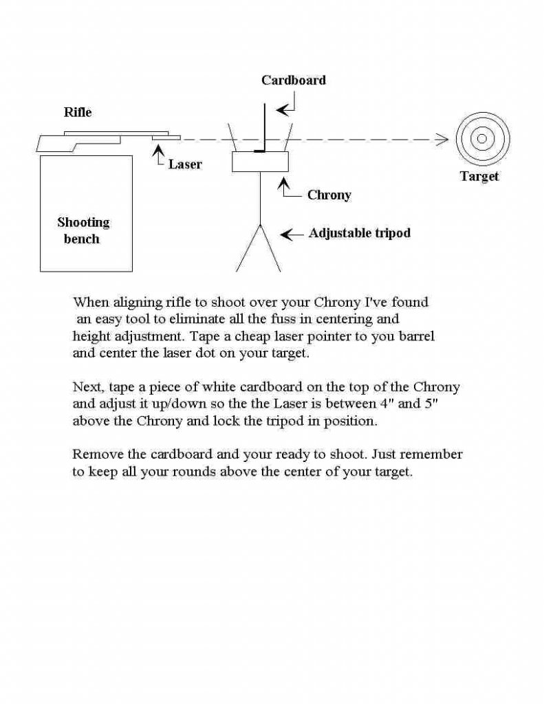

Yep. :'( I have got to put longer legs on my shooting bench :( a 34 grain bullet going 3400 fps does not confine itself to a small hole, it took every thing out including all the cables. ::)
Re: Hornady Sixth Edition reloading manual, Please explain this to me!
« Reply #11 on: September 30, 2008, 10:15:18 AM »
Offline LaOtto222
  • Posts: 3828
« Reply #12 on: September 30, 2008, 11:53:32 AM »
Thanks for the sympathy ;D ;D
« Reply #13 on: September 30, 2008, 01:48:55 PM »
There are two kinds of chrony users, those that have shot a chrony and those that will. ;D I almost shot mine the last range trip, I had it all set up and  4 targets on my target holder 2 high and 2 wide, when I went down range to post new targets I posted a pair of addititional target below the top 4, when I got back and was already to shoot, I just happened to shoot at the upper targets first, when I got down to the bottom two, I just happened to notice that my bore was in line with the left skyscreen supports, even tho they're wood, I'd hate to hit one of em, it may still damage the chrony....so that's my closest call so far. ::)
Offline LaOtto222
  • Posts: 3828
« Reply #14 on: October 01, 2008, 01:15:07 AM »
With my set up, the tri-pod is down as far as it will go. I had shot two other guns, and now I was ready for my 3rd. I have a Bell & Carlson tactical stock on a Remington 700 221 Fireball. Any way the stock cocks up the gun a little compared to the others, making the front end lower. I have a Mueler tactical and had it set at 20X so I could not see the sticks on the Crony. I was all set up to make my first shot, just lining it up. I touched the trigger (2 oz) before I was really ready and bam hole through the Crony :o >:( I am going to have to get longer legs for my bench so I am not so close to the Chrony when I shoot. I do not have that problem when shooting off of my Lead sled, but off of bags, it is just too close. :( I have an extra set of sky screens and sticks to use now. The only thing in the Crony I saved was the battery, and of course the remote, even the cable going to the remote was shot through. Those 34 Grain bullets open up real quick and have a shot gun pattern going through. :-[
