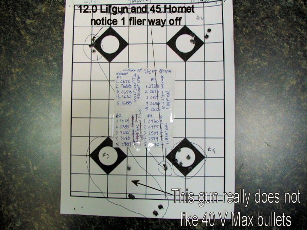

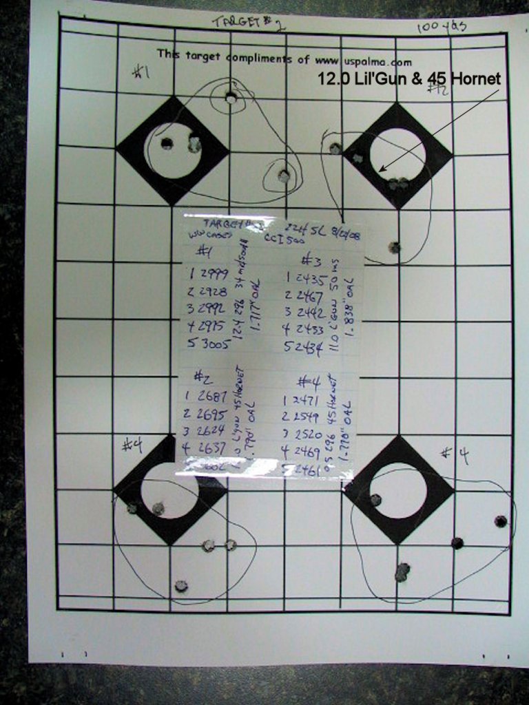

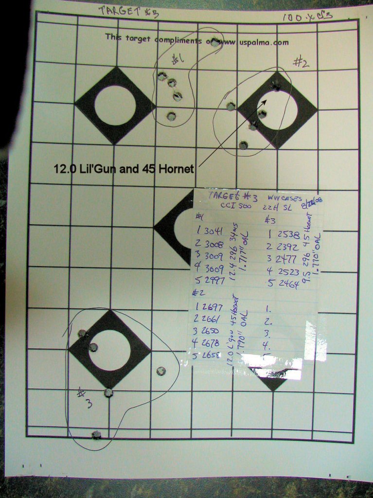

OK, I tried the Lil'Gun and 45 grain Hornady Hornet bullets. I shot them out of a 20" barrel (Handi 22 Hornet SL) I used CCI 500 primers and WW cases. I have three different targets with this load on each of them. Not bad, but nothing to write home about. BTW my gun hates the 40 V Max bullets. It has demonstrated over and over it does not like them.
Shot at 50 yards average Vel = 2666; SD =26.61 Notice the flier going way off?
Shot at 100 yards Average Vel= 2649;SD = 40.43
Shot at 100 yards Average Vel = 2669; SD = 18.74

I think you will find that the small pistol primers give you better results. I messed around with Remington 6 1/2 because I had them on hand. I then bought some CCI 500 primers. I think I am getting slightly better results with them. I looked for some AA 1680 to try with the heavier bullets (45 - 50 grains), but could not find any. I ordered 2 pounds through a local store and I was getting low on H 110 for the lighter bullets in the Hornet and for my 357 and 44 Mag so I ordered 2 pounds of that as well. They said it would be 3 - 4 weeks before I got it. I think I am going to suspend shooting the 22 Hornet until the new powder arrives.

I agree. Those groups were not quite there yet were they?  I will be going out this morning and testing the loads I just listed.  The only thing I wanted to add was about pressure signs.  The 2 loads I already tried seemed to be very mild indeed. The cases looked like new after shooting and the primers were not flat or cratered. They did not extract hard.  The loads were really quiet to. I took off my ears to listen for a few rounds. I ended up leaving them off.  They were both mild loads in my CZ.  But it was wise to start there. I have more confidence now in the loads I am reading about on these post.  Look forward to your next post.
