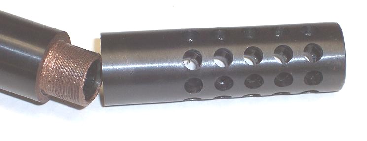

from your description it sounds like a 270 Ultra Comp.
That would be a factory installed muzzle compensator on the rifle.
Generally, the .270 Handi rifles are excellant shooters.
Here's what it looks like removed from the barrel:
Bill
Re: .270 ported barrel problems
« Reply #2 on: August 16, 2008, 04:10:46 AM »
I've got a couple Ultra Comps, a 30-06 and a 270, had another 270 but sold it to a fellow member here, they all shoot very well.  Have him read the Handi Basics 101 and spend some time in the FAQs and Help sticky.  ;)
