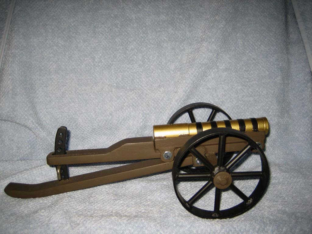

I have the main tube almost done on this one. I went with a solid tube instead of a breech-loader. This one is 1.72" cal and bored out of a solid round of 4140. I went with a 1.125"D x 1.5"L powder chamber. I'm doing the banding now. The center band is done and is getting etched with some decoration sometime in the next few weeks. We're in the middle of moving houses, so shop tie and space are kind of "yet to be determined" for a while. It'll probably October before I get around to the finishing the carraige parts. It'll be next after I finish my Sikh standing mortar.

     Don,   That's  going to be one terrific golf ball blaster!  Be sure to take a few In-Process pics when you get a chance.  Same with your Sikh Standing Mortar.  Can't wait to see that one, because we know the tube is very well made and works extremely well too, (BINGO Contest thread; see Don's video clip).

Don,
Curious: Why do you have the muzzle, narrower than the breech?  I've only seen the configuration reversed, as in the illustrations I posted above.  Really nice project.  Congratulations! I think pre-trunnion pieces should qualify for "Rambo" dolls.  Separate the men from the boys; so-to-speak ;D

The actual final shape is going to have a 7" re-enforced breech section whose outer dia is the same as the muzzle ring.It'll have a bladed front sight as well, which was also used on quite a few historic pieces as well. There's actually quite a few medieval muzzle loaders that are more or less constant dia down the length. I kind of bastardized several different designs into one, though. I pretty love them all, so I took the barrel contour of some of the breech-loading designs, but kept it strictly muzzle loading. I had a 24" tube to work with and my machinist buddy could only do a through-hole. I wanted to retain as much barrel length as possible, so i made my powder chamber 1.125" dia x 1.5" long and kept ~20 of actual barrel length...gotta keep those golfballs accurate! :)  For a historically accurate, yes, this one would have had about a 6" x 3/4" powder chamber or so, with the breech being smaller overall dia. Since I opened up the chamber dia, I had to keep wall thickness thicker and thus the built up breech. I want to mess around with "machined-rifled" projectiles (like this:http://www.defensereview.com/1_31_2004/FRAG%2012.pdf , but without the explosive round) with higher velocities and fun stuff like that was the reason for wanting the extra barrel length. I love medieval designs, though so I went with the historic carraige and wrought banding.
My favorite is a Maximillian cannon that I'm *still* trying to get a Swiss museum to respond to emails over. It has an octagonal, 8" thick breech that tapers over 56" to the muzzle that's ~3.5". No banding though. There's a pic of it in Dudley Pope's "Guns". I'll have to stop by Mike and Tracy's though to rifle it, though. :)
