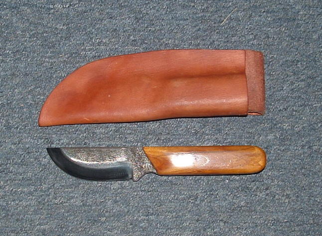

I just finished one made from a Sandvik file; in fact I started out my knifemaking career making/selling file knives.  I don't see any point in annealing an already hardened piece of steel, saves you a heat treat step if you don't have a forge(which I don't). It just needs to be ground "cool" and tempered.  The blade colour should never go beyond gold/straw as you grind.  Granted it's a bit harder to grind the blade like that, but on a belt grinder the point is moot.   I use a temper/freeze/temper/freeze/temper cycle. My neighbors/son-in-law all have used them for years and won't use another knife.  I do soften the handle/ricasso area by sticking the blade portion in a can of water and using a blowtorch to heat the handle portion to blue.  Makes drilling with conventional drills easier. Here's the new one.  I've worked only in stainless?D-2 for years, but found this one already ground in a drawer and finished it.
The handle is stained birch.

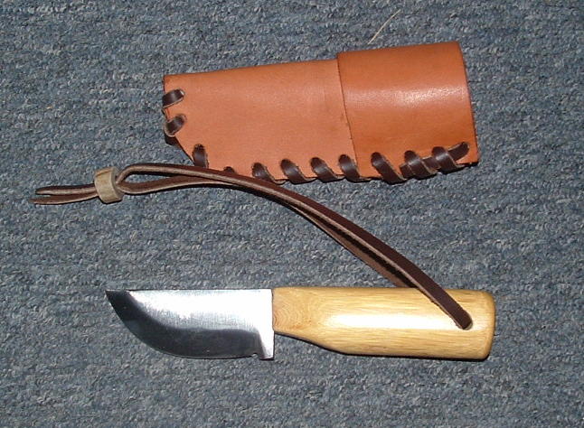

I've made a few from files and some from power hacksaw blades. I grind mine and try to not take the temper out. I (like Joel) don't have a forge. So far I've been successful. Mine aren't show pieces, but they make good users.
Here are a couple I have made.
