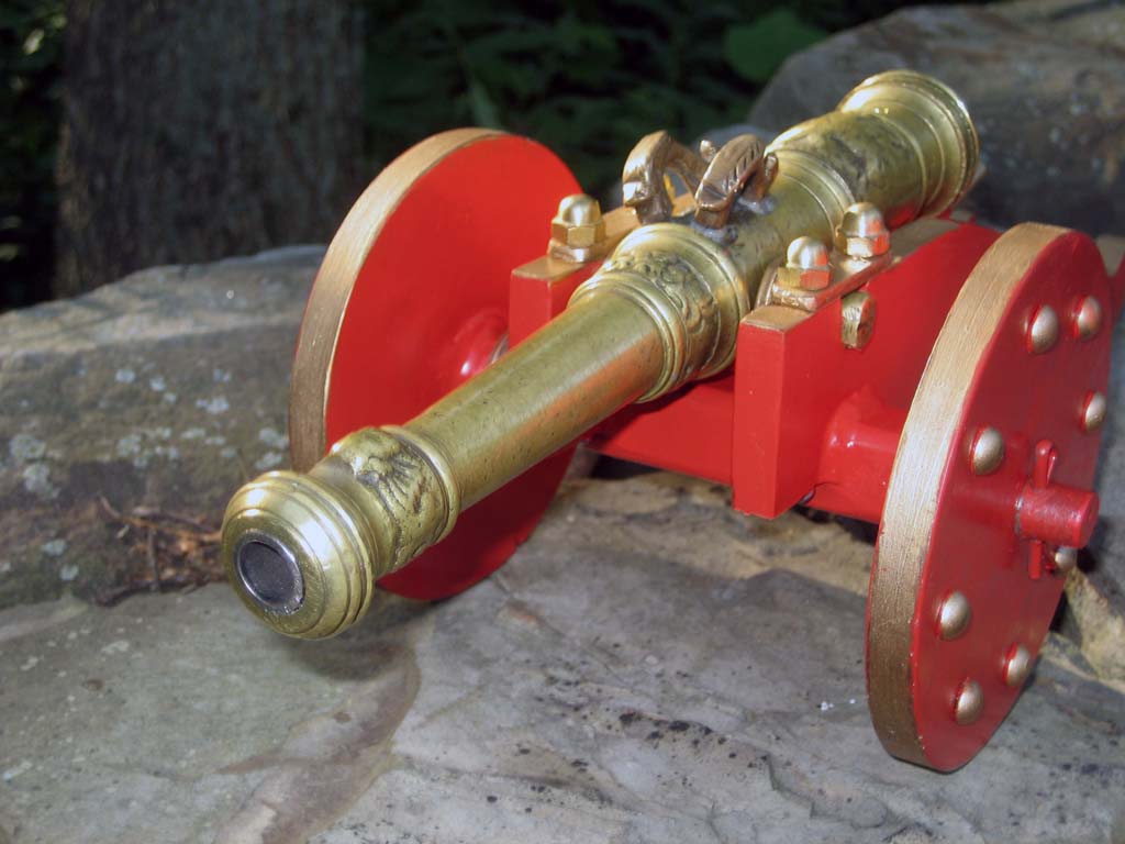

      An old friend of ours, a U.S. Marine, stopped by today to get the 50 cent cannon factory tour.  He brought along a real treasure from our gunsmithing school days together, 30 years ago.  He had us clean up the exterior of a free bronze casting he received from his cousin, a foundry school student.  We all agreed it was to be a wall hanger because of EXTENSIVE POROSITY in the bronze.  Like a lot of people, he wanted to fire it at least once before plugging the vent and retiring it.  We all decided to do this under CONTROLLED, TEST PIT conditions for safety.  One .730" Dia. lead ball and an appropriate powder charge were used.
      If you buy or are given a free cannon which exhibits porosity, be WARNED; don't fire it with blanks or ball loads as it could easily end up like this one.  Porous castings of any metal are WEAK and DANGEROUS!!  The proof is in the pics below.
FYI,
Mike and Tracy
A side view showing the amount of damage done by a single shot.
Porosity was extensive, even the cascabel had a bunch.
Porosity in the chase and also in the trunnion material.
The bulge on the right side opposite the "flap" of bronze is more proof of this tube's weakness.
More porosity evident on the muzzle and the 3/4 inch bore.

     Douglas,   We are pretty sure he polished this piece a bit AFTER we tested it in the pit behind the 5 Ft. diameter Cottonwood, not before, but we worry about those bronze signal guns near the main flag pole on those Army posts I was assigned to.
     Cannonmn,  100 grs. of Goex Fg BP is NOT excessive for a 75 Cal., six pound cannon.  No patch or wad was used.  The ball was a rattle fit in the bore.  For everyday firing of a well cast bronze gun in our experiece, 60 or 70 grs. is a better target load for a six pound cannon of this bore size.  With a breech wall thickness of 1.0", a solid, bronze gun of this size should stand a proof of 200 grains of BP easily.  I don't know how to explain the porosity present in this casting other than to say, with no exaggeration, that, when we drilled the bore, the surface inside was about 50% air and 50% bronze. Now is it clear how compromised this gun's metal was??
     The outer metal was much better than that in the gun's interior.  We think that this fact could contribute to the hinge-flap effect of the single, blown piece.

Assuming the barrel was sand cast horizontally and with the top up, it is not beyond possibility that the porosity simply floated to the top of the mould cavity leaving it ready to fail.  Shooting cannon were normally cast vertically with the breech down with a large deadhead/shrink feeder above the muzzle so that shrinkage porosity would occur in the cutoff/noncritical parts of the barrel.
It's too bad that these casters of non-shooting pieces bore more than an inch or so of the bore.  It makes the owners want to shoot them since drilling a vent is so easy.  That barrel would have made a nice desk top piece intact.

      Well cast bronze guns are just fine; we would not hesitate to use them within normal safe practice limits of charge and correct weight of ball.
                              One LAST time:  Bronze IS NOT the problem, the CONDITION of the Bronze Casting WAS THE PROBLEM.  It was fatally flawed    in that it was EXTREMELY POROUS which means it had a lot of air where the bronze should have been.  Mike and I let the owner know what could happen; he insisted on testing it one time only.  All of us tested it SAFELY!!!  Nobody was hurt.  Period.  Sorry, no movies; this was thirty years ago.
