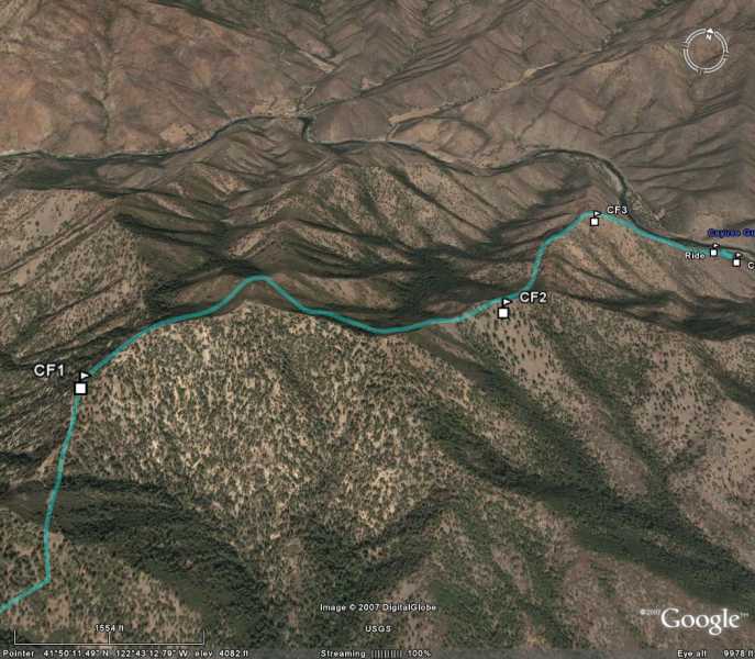

I use the Track mode a lot in my current and past Garmin gps units.  While they may have different buttons the Garmin Legend, 76C, 76Cx, and the Rino HCx operating language is similar.  My tracks are never in a Straight Line.  I have transferred them from my gps units and displayed them on Garmin Map Source U.S. Topo maps, and USGS Topo Maps.  There are a few times I would have drown in a lake or fallen off a cliff if I had not circled around them.
Sometimes I create a route, especially if somebody is going to pick me up at the bottom.  Again I follow the country and not a straight line.  I downloaded this route to Google Earth.

Last summer I believe I posted a pre-planned return to my pickup after scouting an area.  The return was in the dark, before moonrise.  The area was covered with head high snowbrush, thickets of timber regeneration, and old logging slash on the ground.  It was like being in an inkbottle and I had to check the gps about every hundred feet to stay on course.  I switch back and forth between the map page and the compass page checking the pointer.  I had extra batteries with me and I kept the screen backlight.  A straight line was impossible between the vegetation and the down slash, but quick glances at the screen kept me on course to my pickup.
You can recalculate your route as often as needed.  One of my favorite walks is along and a lakeshore, and I have a waypoint at a location.  The lake has a number of small arms that I must go around, and not the most direct route to the waypoint.  During my walk I will take advantage of the Recalculate option.  I try and practice the options I use on the gps so that when I am tired and burned out they become automatically.
