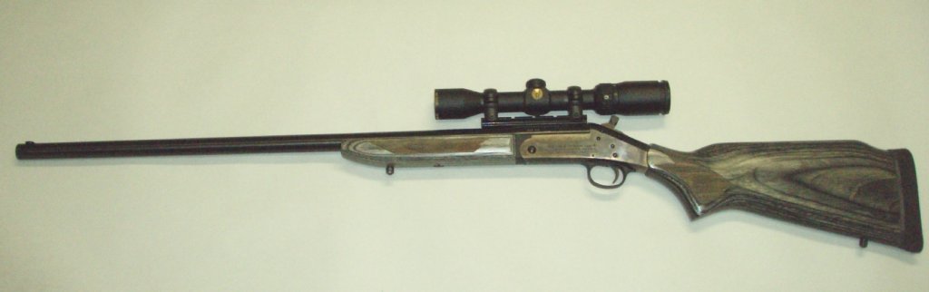

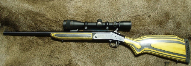

Posting a pic is the best way to describe your item in a classified ad, then there's no doubt, if you're in doubt about what you have, ask.  ;) Synthetic stocks are black plastic or possibly camo, no question there. Resin lams come in two colors now, cinnamon and camo, although they've been made in many different colors in the past, see Let's See Some Handis in the FAQs, there are pages of pics. There are also other stocks, the Topper Deluxe Classic are checkered walnut, as are the Buffalo Classic and Target. There are also wood camo stock that come on the turkey shotgun.
cinnamon lam
camo lam
palletwood lam
Red lam
gray lam
Bumble Bee
