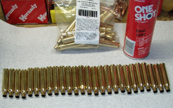

Getting the case lube off?  I have used the oil pad as well as the Hornady one shot.  I like the spray better, I just rack the cases in the holder and sprayed a quick shot turned the holder 90 degrees and sprayed again.
Am I doing this wrong?

Sounds good to me, I lay em out on a paper towel, spray down the row into the neck and on the shoulder, then come back down the row a little lower, roll all of em 180ยบ and repeat. I wipe them off with a paper towel after they're trimmed while they're still chucked in the Lee lock stud. ;)

You have to do it with bottleneck cartridges, but if you can do without don't even think about it.
What about the Lee Colliet die? I think think you need to use lube with it (I have not been, but I only sized 100 cases so far for my 22-250)   It only neck sizes by pressing against the case. Since we all shoot single shots here, why full length size cases?
Those that I do full length size I use sizing wax on, it wipes right off with a rag.
