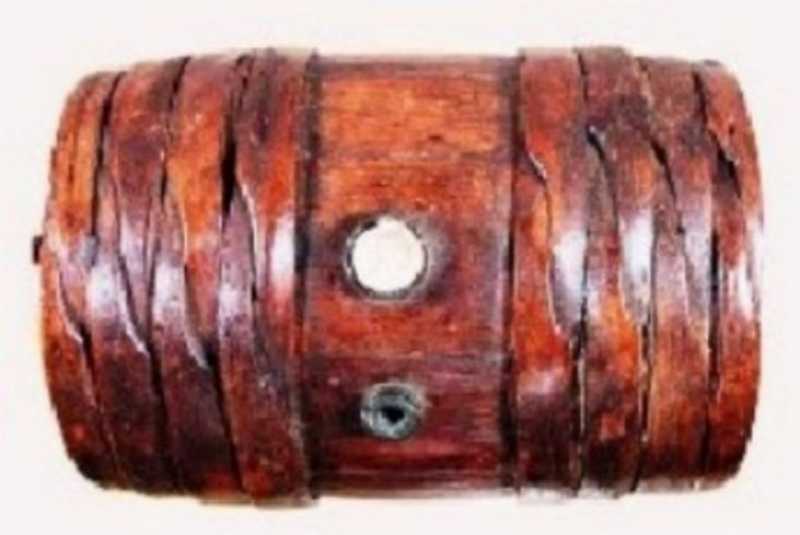

Re: Powder kegs?
« Reply #11 on: June 26, 2008, 04:57:43 PM »
This is supposed to be an original powder keg from the 19th century. Somewhere along the line someone must have put the nice finish on it. It's interesting to see how the steamed hoops are fastened on the keg; when they dried and shrunk it must have caused enough friction to hold the hoops together and enough pressure to hold the staves tightly.
