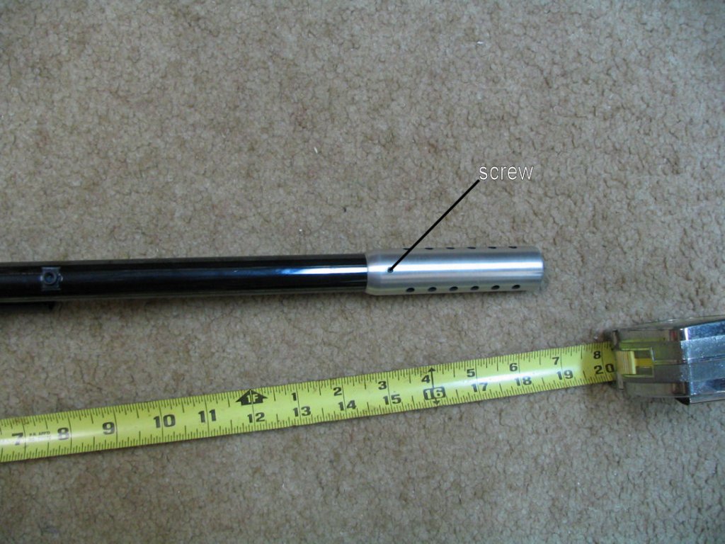

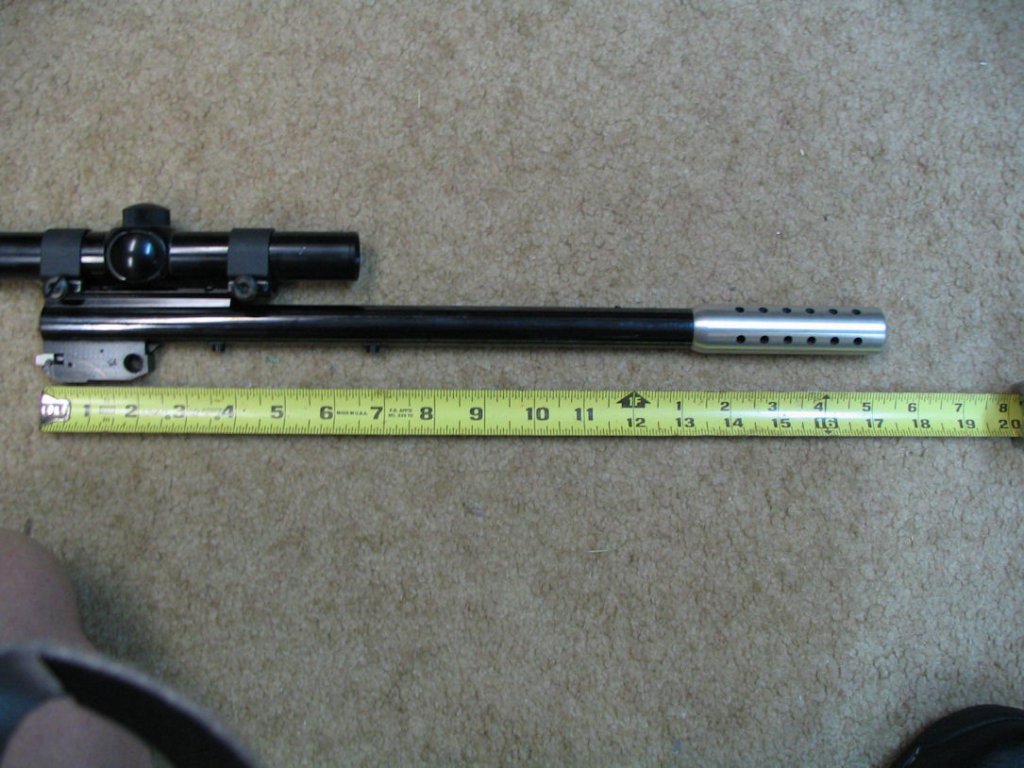

I had a 14" 44 Mag barrel that I had a muzzle brake added so that it was just a hair over 17". There was a screw with Lock Tight and tightened in and the head removed. It would be very difficult to remove.
The screw

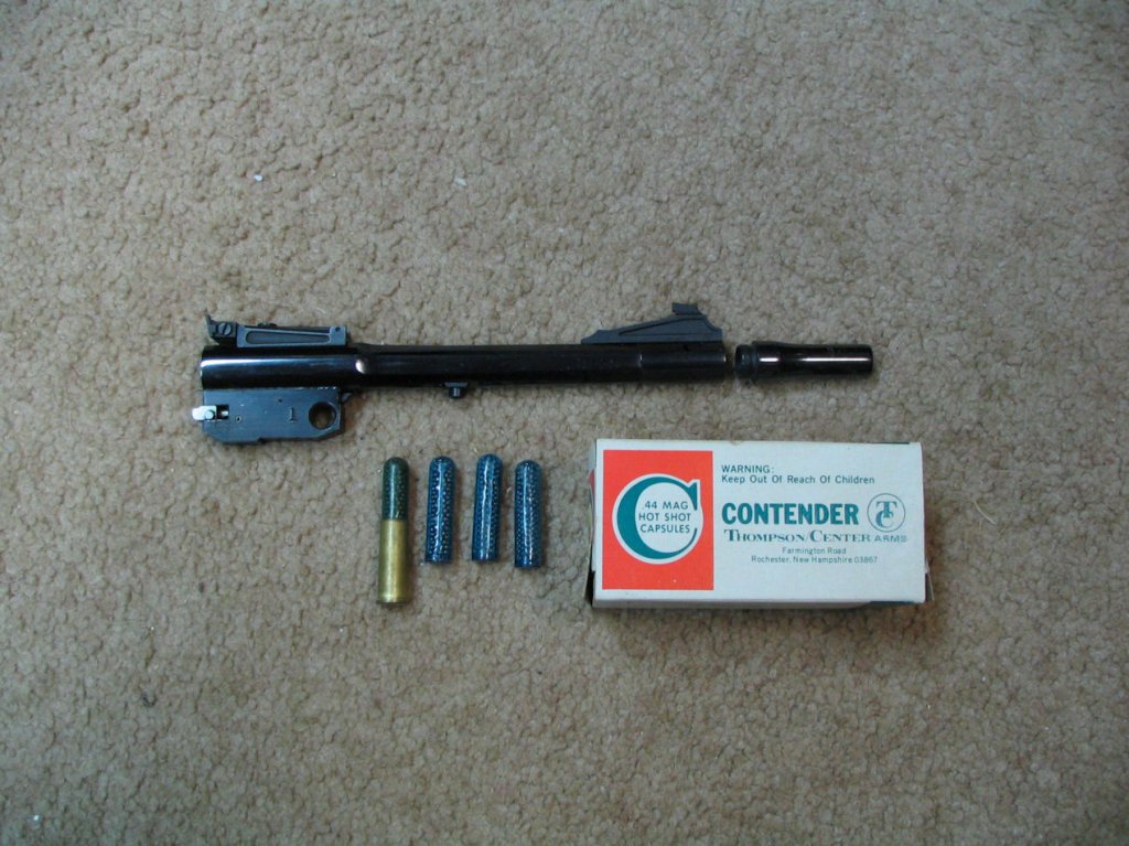

I have a 8" 44 Mag barrel with a choke that has straight grooves cut in it. It sticks beyond the barrel about 3". Hot Shot was a brand name by T/C for a plastic cup that was filled with bird shot. The choke was used to strip hot shot covers and stop the shot from rotating from the rifling and ruining the pattern. They were expensive and did not sell very well, so they were dropped from their line years ago. I still have a few Hot Shots left over from the old days. They were supposed to have about the same hitting power of a .410.
