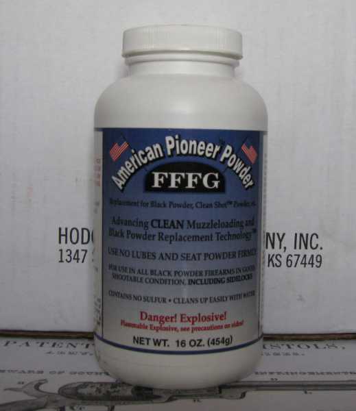

Question:    Is American Pioneer Powder fffg easily cleaned from your weapon after a days shooting session?   It is said that it burns clean, so I'm assuming it may clean up easily too.
I occasionally shoot a .44cal cap and ball revolver for enjoyment using Pyrodex fffg and it's a pain to clean up after.

 :)  Well; after checking with all the local shops around here I found that two carry the Triple Seven, but none of them carry the American Pioneer Powder.   Nor do they carry Remington #10 Percussion Caps, which I've heard work well with the Colt replicas, "but not on the Remington's ".
Sooo, I coughed up the 'Hazard Fee', and ordered some APP FFFg .   At least I'll know if it was worth the hassle.       ;D

 ::)  The Stuff came in.
Tried the Caps on the cylinder nipples right out of the tin.   They fit decent, not tight.    Now to do the testing.

Well; I'm back.  Had a great time getting a few results.
Began at 9:00 a.m. this morning.   The weather was a humid 85 degrees and climbing .
Didn't bring enough powder and I shot nearly 80 rounds before I ran out .   The powder did great.
 No problems with the humidity.  I've had the powder in a Flask for days now, and there was no sign of caking as we've heard about, and it made plenty of smoke.
I used from 25 to 35 grains of powder.   The 35 grains makes a big boom!!!   This powder shoots clean, and did not cause any binding or stiffening of the action during this short session.

 :D  Flilnt is right; APP cleans A-Okay.
Cleaning up APP is best done with hot soapy water and a hot water rinse.   This powder fouling doesn't gum up, but it has an oily consistencey which helps keeping everything operating smoothly.   However, it is still dirty, and gets into the same cracks and crevises.
On the first gun I used solvents, and it does a fair job, but tends to pass over the hard to get places, and I ended up spending extra time there.  Clean-up time takes about 30 minutes.   With the hot soapy water most of the grime came off immediately.   Had to take a toothbrush to the nipple heads, but I figure that build-up was from the Percussion Caps, and not the APP.
I like the APP because it doesn't have a problem seizing up.   I like my guns clean, so guess I'm going to have to enjoy stripping 'em down and giving 'em a bath. ;D
