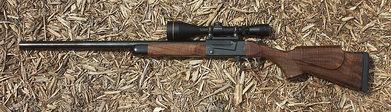

I just got a shotgun barrel assembly (with the larger monoblock) converted to a rifle caliber. The new barrel is press fitted and pinned into the monoblock. It is a 5-groove Bartlien barrel with a 1-in-7.5 twist, chambered in 6MM-06. I have not got to the range with it yet but will try to work up some loads for it with 105-grain Berger VLD's. According to Hornaday it's possible to get 3,400 fps with them at acceptable pressures. With the 4-12X50MM Leupold scope it weighs about 11.5 pounds per my bathroom scale.
