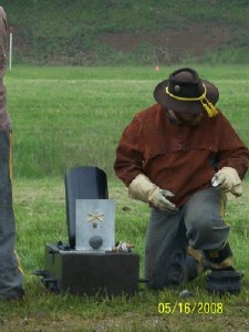

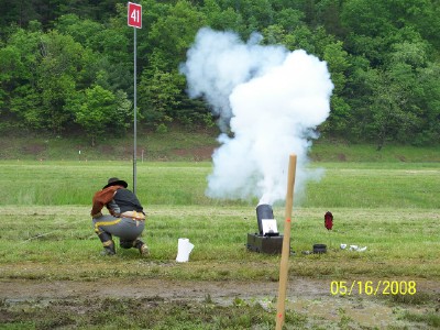

my 24 lb confederate mortar in action at the spring nssa nationals.  17th out of 53 mortars   51 feet 1.5 inch
Offline cannonmn
  • Posts: 3345
Re: MY 24 lb in action
« Reply #1 on: May 21, 2008, 08:28:59 PM »
Thanks for the pix.  I'll bet that's a steel mortar with no liners, isn't it?  There were quite a few "Confederate mortars" like that made up for NSSA members within about the past 10 years.

For the most part I shoot 300 to 315 of 1f and I have some friends with 24's that shoot 700 to 900 in them. The other 4 - 12 pounders we shoot run about the same but one that shoots 240 to 260. and that's at a range for 100 yards.

Well, with my old powder I was shooting 1100 grains to make it to 100 yards, but now i have bought a keg of really hot cannon grade so I am down to 650 for a base charge. I would be shooting 1f but i got a good deal on the cannon grade so i will use it up and buy 1f next time. hey mr gadget are you going to the artillery shoot in august? at the fort? i have never been and I am really exited to go.

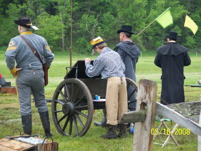

the carriage you see with the limber bod on it is for moving my gun around camp on it makes it easier. i am building a 5/8 scale limber now to pull it with tho, does anyone have a good line on quality/ cheap iron works for the limber box it self? maby the copper top
