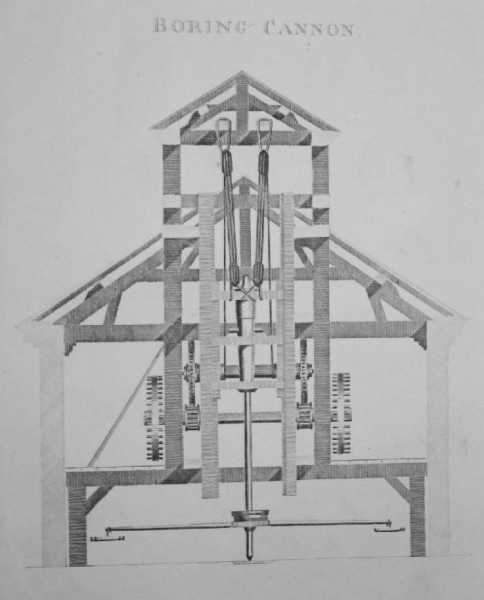

In the old days 18th Century the barrel was stood on end and they were bored down into the barrel,
as equipment improved with the advent of steam power lathes and boring machines which would
hold the piece horizontal became the norm.

I have this picture of how cannons used to be bored.
Re: Casting with steel
« Reply #4 on: March 24, 2008, 08:05:10 PM »
Always thought if they had rotated the barrel instead of the drill, that would have been a good machine.  Gravity feed and gravity chip removal.
