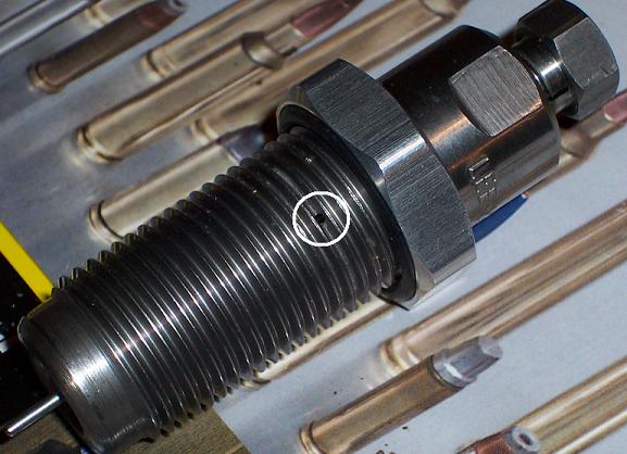

If you have major build up disassemble and clean as Kurt describes and pay close attention to the vent hole to make sure it is clear.  Your vent will likely be through the side of the die in the threads.  They always seem to end up under the lock ring. ::)  I keep a spray can of electronics cleaner on the bench and after every few hundred rounds, or if a problem devellops, spray the die out while still in the press while covering the rest of the press with a rag.  This avoids build up.

Here's a picture of the vent hole location (circled). A small paper clip end will fit in the hole.
Bill
