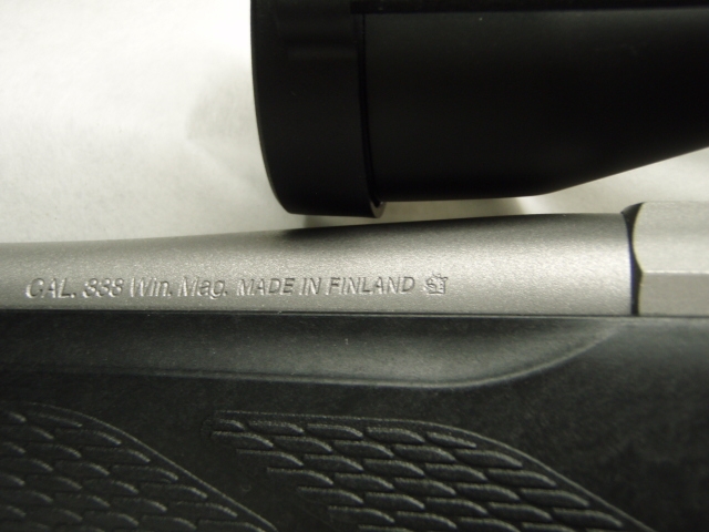

Thanks Tim, If I go the unblued route what are your feelings on the polished stainless vs. a matte (bead blasted?) stainless barrel?....<><....:)
Re: .22 WMR Versa Pak
« Reply #9 on: January 13, 2008, 05:09:38 PM »
I really like the appearance of my Tikka stainless, it has a matte, bead blasted texture, it's a very nice finish and I bet its very durable. ;) Tim
