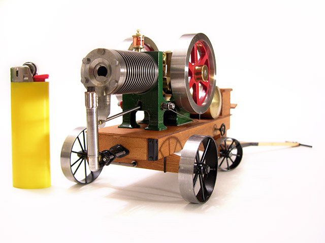

hitandmissman ,
I have about the same background as you, steam and other engines:
My suggestion would be to decide on a projectile, bb, .25 slingshot ball, golfb all, pop can, billiard ball, bowling ball, or whatever. This site has plans already drawn to accommodate popular sized projectiles, and if you follow the plans and keep in mind the "wall thickness equals powder chamber diameter", you will end up with a cannon that won't blow up on you.
Listen to what the other members here have to say, they will help if they can and this board is VERY well moderated.
If you add researching of the history of the guns on top of building them, you will have a lot of fun. There IS a lot of satisfaction to seeing that engine running for the first time, but, there is JUST as much fun lighting that fuse the first time as well!
That cannon has a .177 bore with a pot metal toy carriage!
