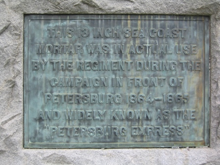

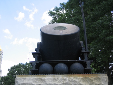

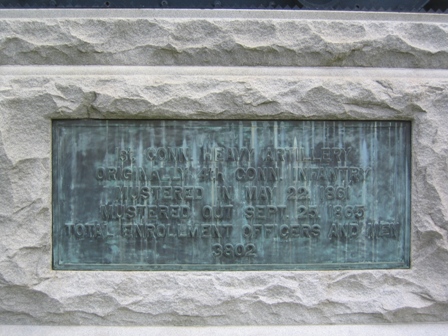

     Thanks cannonmn; this is a truly first class resource!  There are quite a few references to mortar fire, methods, practices, etc.  The photos below were taken this past summer about 80 yards from the Connecticut state capitol in Hartford, CT.  We are NOT saying that this is the famed "Dictator".
     From our field notes we have the following markings as appearing on the muzzle-face:  At the top,  17197 lbs.  No. 95  J.R.E.  and, along the bottom,   Fort Pitt PA. 1862
FYI, Mike and Tracy

M&T that picture is germane to the discussion and the reference text for sure.  The author commnanded the Connecticut  artillery.

« Reply #8 on: January 08, 2008, 11:50:09 AM »
Tx for pic of the CT 13".  When I wrote the article back in '86 or so, I decided it could not be the Dictator since the weight did not match the weight shown in the painting of the D. at P'burg.  Wnen the State of CT wanted the Dictator for display at the capitol, there were extras at Fort Monroe, VA., and one of them was selected (probably the one stored closest to where it had to be loaded on a barge!)   and sent.  Fort Monroe was in fact the depot where the Dictator was sent to P'burg from, and was most likely where it was returned to.
