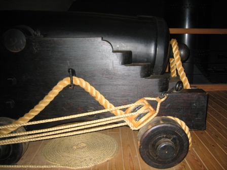

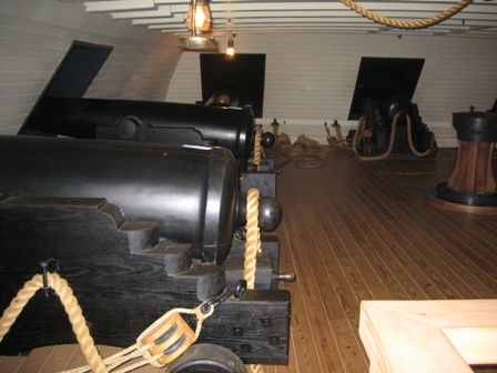

REPLICA 42 Pdr. conversion rifles AND 8" naval chambered cannon are pictured here.  These are the guns which SBR made following their study of the originals which came from the Cairo wreck.  It was very dark inside the casemate, so some of the camera angles are not perfect, but with a big "No Flash Photography" sign posted we had to bend the rules a little to get ANYTHING out of this experience!   The stern was not included in the display.  This Mississippi River Museum is found on Mud Island near downtown Memphis.  This "War on the Mississppi" section featured a Union, "City-Class" Ironclad Gunboat and many historical photos and artifacts from this type.  Also there was a 42 Pdr. on a wooden barbette carriage mounted on a bluff overlooking the river, representing a Confederate battery.  All in all very interesting!  AND, if you like Bar-B-Que like we do, give Jim Neely's Interstate Bar-B-Que just north of the I-55 and Route 61 south side of Memphis at 2265 South Third St. a try.  It's in this top three in the country per us.  We have been there twice now and will be back again!
DD, hope this helps you out!

     I am trying to restore these, but they don't want to display except as links which I detest.  I'll try something else.
Well, look at that, finally.  Broadside gun, actual a 42 Pdr. conversion rifle, formerly a 42 Pdr. smoothbore.
All the information we have on these is posted above; hope these restored pics help you.

They did a GREAT job of ceanin' all the mud outta that ship!

Nice set of photos, very instructive.  What is the gun in the bottom photo?

     The gun in the bottom photo is an 8" chambered cannon, mostly used by the Union Navy, but not exclusively.  Weighing 63 cwt, (U.S. not British hundredweight), there were three of these cannon on the USS Cairo when she was sunk by an electrically detonated Torpedo just north of Vicksburg, MS in the Yazoo River, on the cold morning of December 12, 1862.  These cannon were the third pattern of this gun and were located in the bow of the Cairo as the #2 starboard broadside gun,( pictured), and the #2 port broadside gun and the center bow gun.
The 8" gun pictured, made by SBR, represents the original which was cast in 1845 at FPF, (Fort Pitt Foundry) in Pittsburgh, PA.

P.S.  cannonmn,     Mike, a former U.S. Navy ASROC Gunnersmate, told me he knows exactly how they cleaned all that Yazoo mud outta there; a combination of firehoses,
                            mops and toothbrushes were used!!!  Drying and re-painting followed.  ;) ;) ;) ;)
