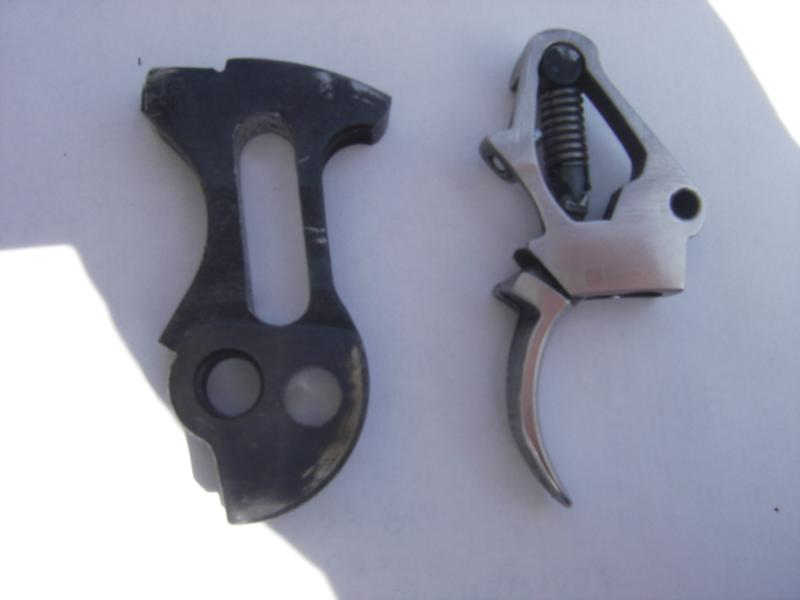

you can swiss cheese the hammer and add a Wolff spring.

Since I had installed a Speed lock Moulds hammer before I had an original hammer in my scrap box. Went to my friends machine shop and used a 1/4" carbide end mill bit and cut the slot and the hole on the bottom the same as the Moulds. Presto we are in the money. Will be useing the same spring as the heavier hammer used untill I can get a Wolff HD spring.

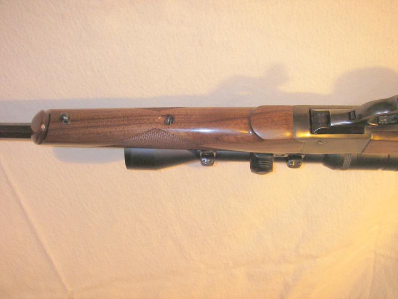

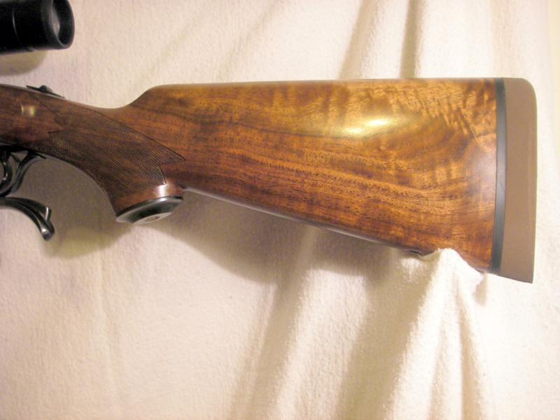

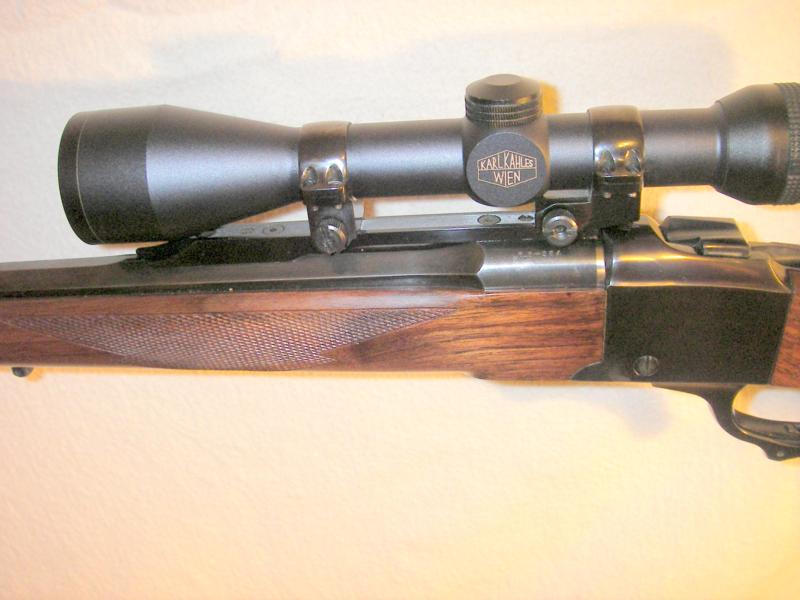

Here is what I got done on my 6.5x284 sofar. I reshaped and recheckerd the the #1B  forearm to look like an Alexander Henry fore arm. Milled the 26" barrel octagon. Rebedded the forearm to a nearly invisible repair. Tightly bedded the forearm and the butt stock to the action, for no wiggle. A complete stock refinish and installation of a Decellerator Pachmyer recoil pad. Refitted the 1/4 rib to suit the octagon. The scope is a Kahles 3-9.
Installing the modified hammer and the Kepplinger Set Trigger is now in progress.

Fred, I'm really liking your #1.  From the caliber and modifications...especially the octagonal bbl and Alex Henry forearm, to the scope and rib.  Almost sounds like something I would dream up...its just that I lack some of your skills...ok...most all of your skills, especially for the metal work.
Hopefully it will shoot as good as it looks.
