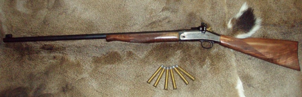

The 45-70 WWG has been discussed some, but for me was just a passing thought, I went with the "45-Uber Magnum", the 45-120-3¼" Sharps Straight. ;D

Nope, not with a Galco leather recoil pad and a 16oz mercury recoil suppressor in the stock. ;)
