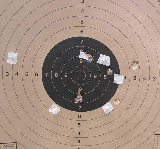

Cast lead balls sprue and all felt wads provided by the club.  Some use patches of what ever material works they can find.  I have been using US commercial made pillowing ticking of late.  My friend gave so locally made lubed patches and I tried them this morning.
First shot  7 o'clock  6 ring, send shot  5  o'clock 6 ring, third shot 9 o;clock 3 ring.  Back to dry patches for the final three shots.
Here is my second target.
Was good enough with my Handicap to be high shooter and bring home the trophy.

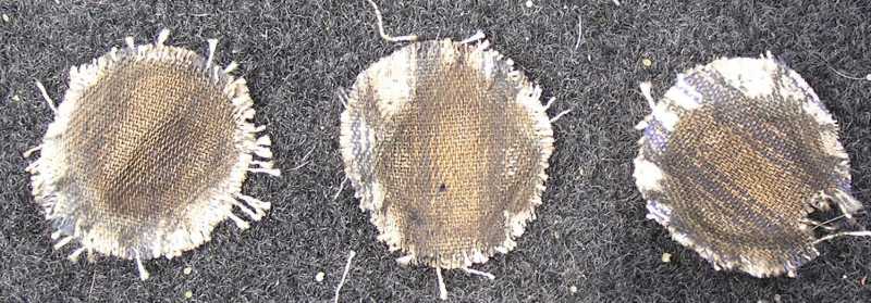

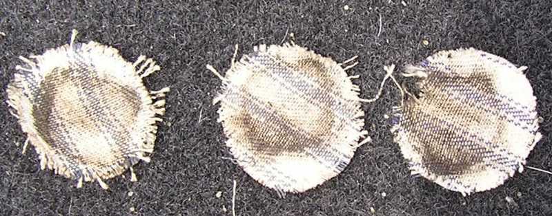

Anybody good at reading patches?
Outside
Inside

     Double D,   thanks for the info.  No, neither Mike nor I ever got into any competition shooting with patched round balls so we do not know how to "read" patches.  What information do they convey to you?  We are just trying to get some idea of what to shoot that will be accurate out of our smooth-bore 100 Pdr. tube.  For cannon balls we are thinking about getting a mold to cast a diameter that is the Bore Size minus the Patch Material thickness times two.  We wonder if you have to figure the lead shrink factor here or not?

Shrink factor is measurable in large lead balls. My 1.125" mold actually throws a ball of about 1.118" - 1.120".
I'm not sure how much information a smoothbore patch can give. The way I understand it, 'reading' patches is more of a rifle thing. A good BP rifle shooter can tell from the patch how well the patch/ball is sealing the bore and engaging the rifling.
