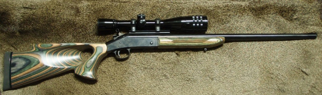

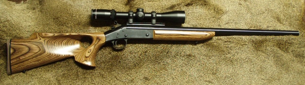

Hey Quick, how about posting a picture of an H&R/NEF Thumbhole stock for this new member.
I just got my camo laminate H&R/NRF Thumbhole stock in the mail yesterday and I like it a lot...
Thanks Tim....<><....:)
 By the way Handi22-250, Welcome aboard buddy, it's nice to heave you here with us....<><....:)
Re: New To The Forum!
« Reply #8 on: November 03, 2007, 05:51:22 AM »
Welcome aboard Handi22-250!! Not much I can add other than pics of the t-hole stocks MSP asked for, each set is $122.50 shipped from H&R, but be patient, they've been reported to be out of them from time to time due to their popularity and them being  available on factory firearms.  Other H&R stock prices can be found in the 2007 Retail Parts Price list in the FAQs. ;) The synthetic stocks can be seen at the mfr's website and on the H&R site.

I do believe H&R is currently out of them. I was able to find a buttstock only, as new, from a fine member here. It cost me within a buck or 2 of a new one but is is a new one and they are not available so I am happy, even if I was not planning on getting one. When the member, cjturner7, a fine guy, posted about it and mentioned camo laminate I could not refuse :). I will be ordering a matching (but checkered) forearm,  when the financial time is right. My set-up will be identical to the top picture posted by quick. I am really impressed with the quaity of the H&R Thumhole buttstock, and t Pachmyer Decelerator pad on it is a nice touch. Chris (cjturner7) had just received it but felt the alignment of his eye and the scope he has mounted on his gun was not what he wanted, so now it is mine....<><....:)
