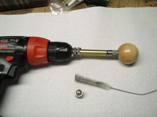

Thanks for the picture, Quickdtoo. I have been using a Pacific lathe type trimmer since forever with the crank and such.  Without the picture, I would have kinda skimmed over this post.  I have 200 .223 cases just waiting for the mail.

Glad i could help. ;)

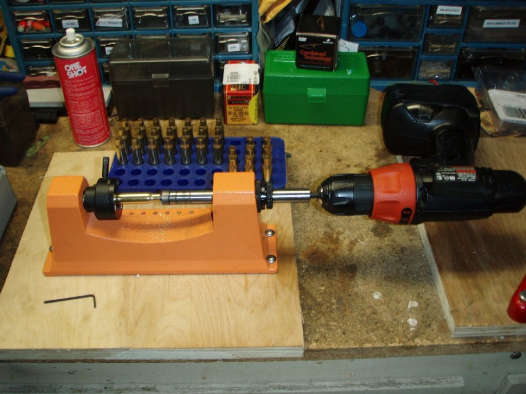

Glad you got the .300 Savage trimmer ordered, I order most of mine from Midsouth, they have great prices and very reasonable shipping, and they do have that length gauge in stock. Sportsman's Warehouse here in town sells some common calibers, but I end up ordering most of them.
Although it's not in the pic, I use one of the orange Lyman mold boxes to support the drill when I use the Lyman Universal trimmer, it's just the right height to take the pressure off the trimmer bushings.

I don't use the wood handle like quick has in the picture (I should though)

That ball handle cutter is real comfortable to use, just costs a little more when you need to replace it. :-\

Plan on using my 18v screwdriver drill, starting at a low speed and adjusting from there.  Safety and comfort level comes first.  I will consider using my drill press at its slowest speed.  I have a small vise that is designed to hold small items for the press.  I may not get beyond the first step and be satisfied with the operation.

I attached it to my 18v drill/screwdriver.  I must note that without the Challenger Ball Grip attached the process would have been more difficult.
I could not tighten the shell holder to the lock stud tight enough by hand to lock the case down.  Reluctantly I had to use pliers to hold the shell holder while tightening the lock stud with a ΒΌ inch socket.
