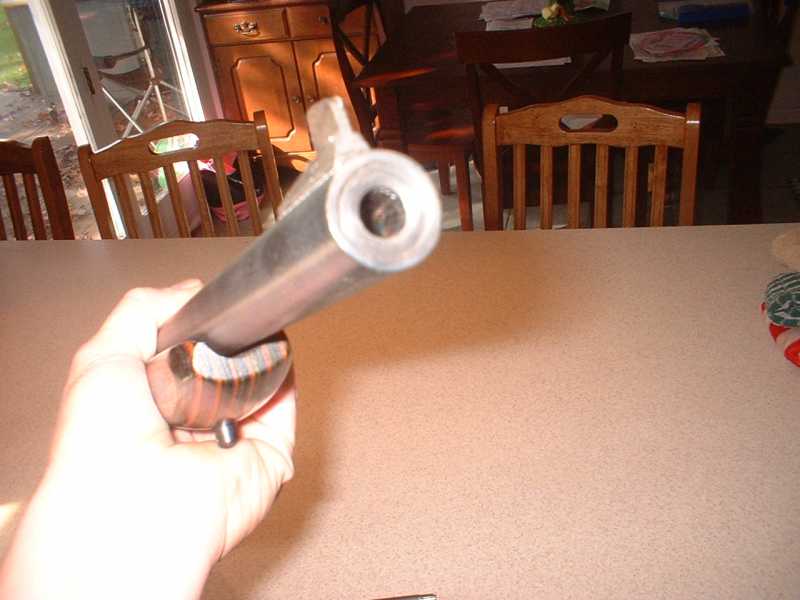

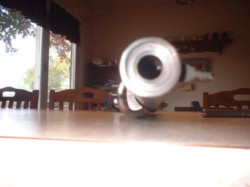

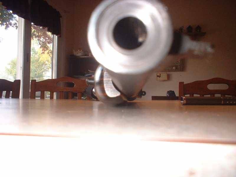

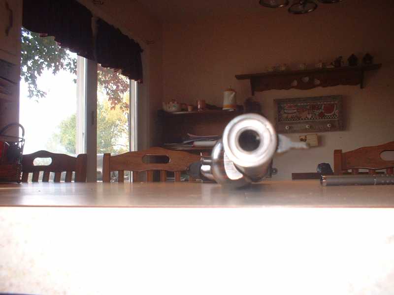

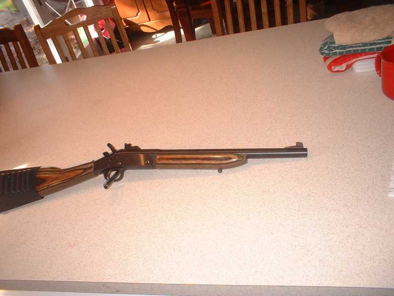

Just got my 357 max barrel. Cut it to 17 inches. Williams peep added . I was gonna put it on a tamer stock & surviver forend. I put it on this reciever Just to see if it locked up OK. Figured these stock looks real nice. The barrel was cut with a sawzall I did the crown with a dremmel. I think it turned out pretty good. What ya guys think? Havent shot it yet. My 2 mth old boy wont let me get out of the house long enough . I ll post a range report asap
Range report -- 357 Max First time in a long time I shot irn sights. My eyes arnt 20year old anymore. I was shooting 180 grn xtps over 24 grains Reloder7. At 50 yards I was getting 3 inch groups . Tried 100 yards the front post completly covered the paper, so went back to 50 yards. From standing position. Still 3 inch group There is hardly any recoil with this gun, the only thing I can compare it to is a 223. I may try a scope on it just to see what it will do. Also shot the 30-06 ultra comp. 165 grain Hornady SST. over 54 grains IMR4350 the best I could was 3inch group. around bullseye. 18 rounds. I polished this barrel 30 rounds ago. Im hoping the groups will shrink a little with a few more rounds . Went bow hunting after that. Seen a real nice 10 pt 60yards or so. Real windy & real warm. All & All a real good day. Jay

That looks good. Those stocks do look good on it. I am waiting to hear how it shoots, but don't wake that little one up with the noise.

Nice crown job. I am going to have to pay Brownells some money for some of those crowning tools.

I did it with a dremil grinding wheel . It looks better in the picture than it does in person. But Im real happy with this little gun. Its my son,s but hes only 2 mths old so Im gonna break it in for him. Jay

It does sound like you had a good day. Have you done any polishing on the new 357 Max barrel? I did stick an "O" ring on the barrel stud before I sent it.
burntmuch
GBO Supporter
114
Posts: 2177
Re: 357 max pictures Range report
Reply #8 on:
October 18, 2007, 11:47:31 PM »
Yeah I polished it right after I got the crown where I wanted it
