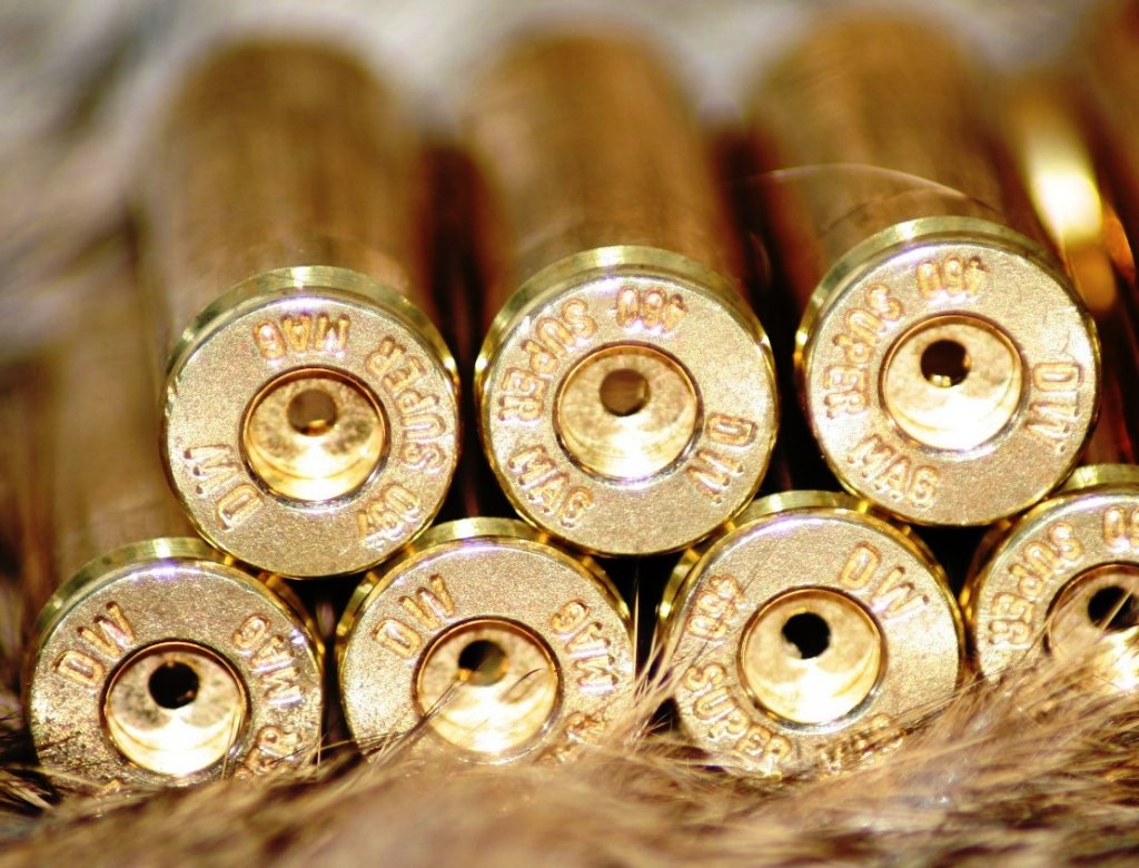

No it is a Dan Wesson 460 Supermag, I can shoot 45 ACP, 45 Win Mag or 460 Supermag which is a Win mag case lengthened to 1.610 in length, it is the only one made and is serial number one.

There was 3000 brass made for the gun for Dan Wesson. They are 460 Supermag headstamped brass made by Bertram brass in Australia if I remember correctly. Dj Bushman (designer of the 460SM and ballistics tester for DW when it was made) offerred to sell me 100 of them for $200.00. So I guess not really parent brass since it is a stretched 45 Win Mag.
