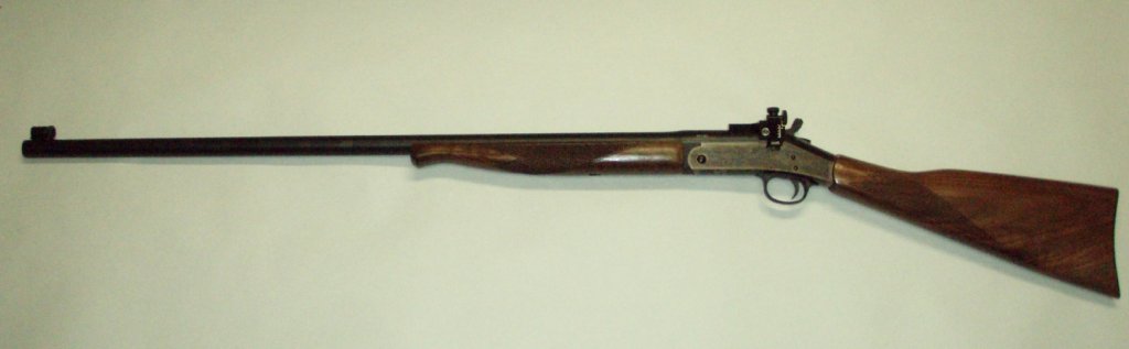

I doubt you'll find em for less than about $325, likely closer to $350. The stock set is checkered walnut with a steel butt plate that's case colored. Mine has a standard SB2 blued frame since it's an accessory barrel, but the frame of the Carbine is also case colored like my 45-120 BC, although it doesn't show well in the pic.
http://rrarms.com/catalog.php?prod=GCR45LC
444 Marlin and 45 Colt BC Carbine
