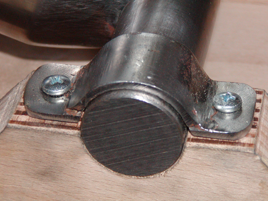

Photo of the jig showing the jig, the steel bar insert, and a sample capsquare.
Photo showing the jig as it looks just out of the vise. The scribe marks are on the back so you don't see them.
Photo showing a finished capsquare with a 1/2" tube instead of a trunnion.

very useful info and pics, thanks for sharing.

Good pix!
