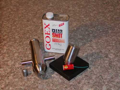

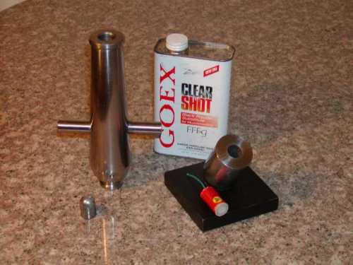

     Wow it worked! I finally can post pictures its a miracle! First off I know the can is the wrong color it is just there for scale. I made these two pieces last week Both are made from H.R.S. and both have the vent hole drilled in at an angle. I will describe the mortar first. For the 4th of July I wanted a fire cracker mortar so I went to the fireworks stand and found these red crackers (M-5000)  with nice long fuses. I measured their diameter and found that a 21/32 (.6563) was a perfect fit. I used a piece of  1.750" diam. by 3.00" long round bar. I drilled the powder chamber with a 1/2" bit and left it with a finished depth of 1."  Then I used the 21/32" for the bore and drilled in 1.250". Next I rounded the base and milled off a little bit so it would stand at about a 45 degree angle. I found a piece of 6"x6"x 3/4" thick metal, so I drilled through the center and welded the base to the mortar so no weld is visible. Man this thing is fun! I put about a 1/4 teaspoon of fffg powder in it, cut the fire cracker fuse in half put one piece in the mortar and press the cracker in fuse first. the report from the mortar is loud and it throws the cracker about 50' up and 50' out before it to reports. I had great fun with this until a tornado touched down about 5 miles away from my house.I had to put up my toys for a while. I tried to get some pics of smoke and fire but it isn't so easy to do by yourself, I'll keep at it though.    I have not fired the cannon yet, I still need to weld the trunnions and find out a safe charge to use. For projectiles I plan on cutting those little co2 cartridges in half and filling them with lead. I have one ready and it weighs just under 2ozs I will paint or tape them to reduce chance of sparking. The barrel starts at 2.125  and tapers down to 1.625 just before the muzzle. Total length is 8.00" bore is 6.500" deep and drilled out to .7188 ( 23/32" )  Trunnions are 5/8" .     Tracy

They look good, Tracy.
Be prepared for a bit of recoil when shooting slugs.

Thanks C.W. I was a little nervous tapering the barrel. I did it in one cut, all freehand. to lazy to off set the tailstock. Now  I got to make a carriage of some sort. Man I hate working with wood.    Tracy
