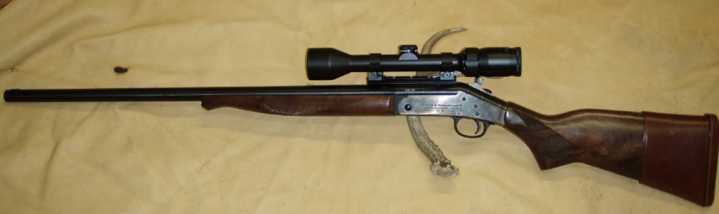

Or you could remove, save the Target stock, and install this one that you can buy from NEF
This is the Pardner Youth with a 12 1/2" LOP.  Add a 1" pad and VOILA! full size.

If you want it to look nice, you can add the Topper deluxe Classic stock which is checkered walnut, it's available in youth or full size, mine is the youth.

I traded a BC stock with a member here.  I got a TDC stock with the recoil pad and checkering which matched the BC stock.  Am I happy?  YES!  Would I trade back?  NO!  It makes the BC much nicer to shoot, and it looks just as nice as that shoulder pounding metal curved butt plate, at least to my unsophisticated hillbilly eyeballs.

WOW, that does look nice.  How much are they from NEF?
