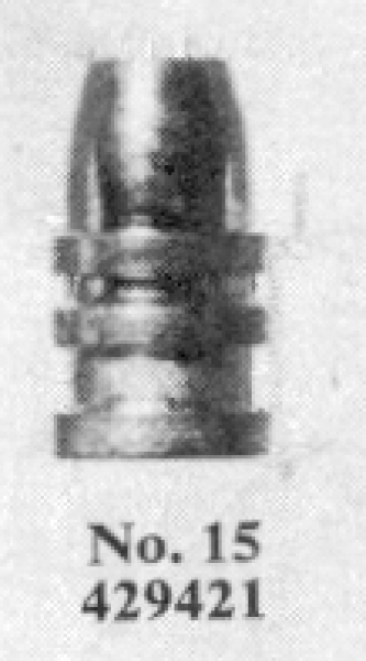

There is no doubt that you are a premeir mold maker.  I have sevearal of your molds made when you were in Arizona and maybe 2 or 3 after your move to Idaho.  None are better actually even though I have 4 or 5 Hensley and Gibbs molds that I think are as good.
But.  I used to talk with Elmer Keith several time a year from maybe '72 till shortly before his stroke in '01.  I asked him if that bullet listed as the 429421 in his book sixguns was an accurate picture of his original bullet and HE told me that it was cast from on original lyman 429421 mold.
To me if it doesn't look like that bullet than it is not an original.  If you will notice and measure the picture the lube groove is pretty wide and deep.  Wider than what many say is a Keith bullet.  Same with the bullet numbered as the 454424.  Suposed to be cat with an original Lyman 454424 mold.
Does it make any difference?  I doubt it.  But those pics are what I go by and to me if they don't look like those pics then they aren't an exact Keith.  In my opinion as of this day I will say no one makes an original Keith bullet period and I will stick to that contention until I see different.
Cast a few post,  some pictures of your 44 bullet, and I may buy a 4 cav. from you if the bullet does look like" what the man himself"  told me was an original.  Simple to post pics and really takes no time to do it.

« Reply #2 on: May 25, 2007, 02:00:50 AM »
Here is a pic from the book SIXGUNS.

  Thank you for the nice picture of the 44 Kieth, which definately is THE original original.
  The one I make isn't exactly like that photo, but it is one from a box of bullets which Elmer sent to a friend of mine with a note inside stating that this was his preferred design.  (I won't give the friends name, but I trust him fully because he knew Elmer very well and is himself the owner of one of the best chronograph manufacturing facilities in the country.)  So it clearly is one that came along a little later than the one pictured.  The only differences in the design I offer are:  The crimp groove on the design I offer is tapered like most cast bullets offered today, and the lube groove has a small angle rather than being straight sided.  The design pictured doesn't give as good a crimp grip, and has to be removed from the mould with a battering ram.  Those straight sided grooves are an absolute no no to bullet release from the mould, and especially so if there is the slightest chatter in the cavity surfaces, and there absolutely will be if the mould is cherry cut.  So, what I make is exactly like the photo looks when loaded, but is an improved design to make it cast better and hold the crimp stronger, and was also claimed by Kieth to be his 'original' design.  I was sent a copy of the note which was in the box of bullets, and guessing from the few samples of Kieths handwriting, believe it to have been his.  I definately agree with your opinion that no one offers the original bullet which you sent the photo of, and I hope no one ever does, because it casts so poorly, which causes poorer accuracy than what I am making, which has the exact same exterior measurements, but looks and is only slightly different in the grooves.
