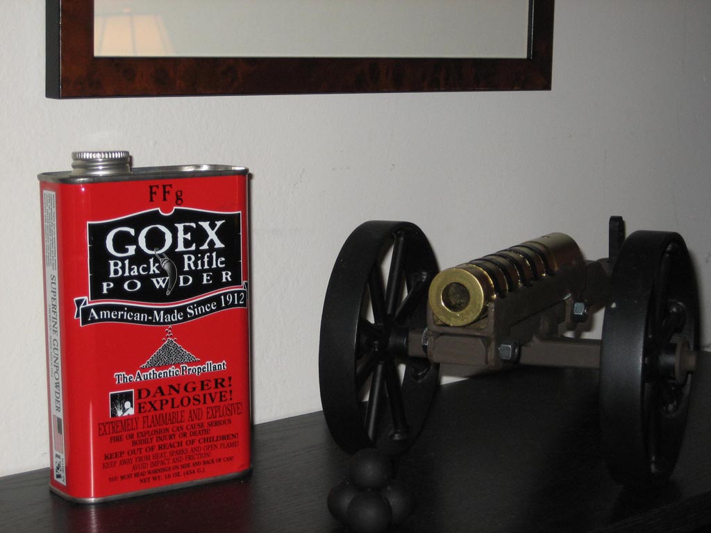

Nice.  Can you show us how the elevation device works.  I have had to modify some I built also. I usually did this to use materials I already had.  In the 15-16 century almost all were different but similar so it does not matter.
Here is a pic of the first real cannon I ever built in 1975-76.  I did not post it because it earlier because you might laugh at the crudeness of it.  It works very well and has fired hundreds of rounds.  The "caps" are handtruck wheel bases inverted.  You lock the trunion with the bolt.  I now know the trunnions are too small but we have shot about everthing you can stuff down a bore.  In the eary proof testing days we shot charges heavey enough to flip it over backward.  The bore is 2" trunnion is about 9/16th I think.  I do not have a recent pic with a powder can but will add it later.  The bolt through the trunnion cap works very well, it is just not authentic to the best of my knowledge.  That is a wrench on the top of the cap.  copdoc
