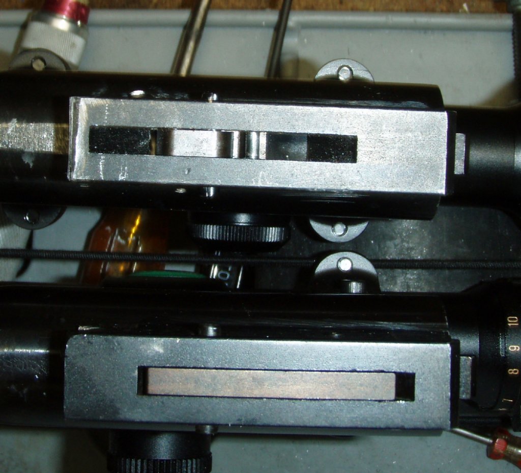

Did some comparing of an ejector and 2nd generation extractor underlug today, it wouldn't take too much change to convert an extractor barrel to an ejector! The slot in the bottom of the extractor underlug would need to be lengthened either by grinding or drilling and grinding and two cross pin holes drilled. This wouldn't be something everyone would want to do, but those that are DIY types should be able to do it. Then installing the ejector components which are the ejector latch $3.09, latch spring $1.20, ejector spring $1.20, and also a lift button for a rimless cartridge which would require drilling a hole, and of course the appropriate  ejector itself which will be $6.18 or $9.01 depending on caliber. The existing roll pins would be used.
Extractor top, Ejector bottom
Hole that needs to be drilled for rimless caliber and finished length of slot

That looks like a doable project. So long you can get all the parts. I would suggest
to make a full size drawing with all the parts in place.
Then make a template with all the pin holes with a sliding ejector and a finger operated lifter. This would make sure the new drilled holes be in the excact place.
The template would be made from the drawing and later when all things work on the mock up the template be clamped to the under lug and the holes drilled.
Really I am not sure how well it would work? Any mods should be made with the reinstatement of the extractor in mind.

I would use an ejector underlug for a pattern, the hole for the large latch trip roll pin is in the identical same spot on both underlug types, so it wouldn't be hard to make a template and use it to index off of for the other 2 holes.
MSP,
I think that wouldn't be too hard, I would drill several holes, then grind the area tween the holes with a dremel leaving enough material for the lifter button hole in the rear most hole which would be centered where the lifter button needs to be.  Drilling a series of holes would save a lot of grinding, the underlug being soft does have some advantages in that it's easy to work with!!  ;)

Fred, the frames are the same, all changes were made to the underlug and ejector/extractor itself. Heh heh, I had two barrels torn apart on my bench at the same time, put an extractor in and ejector barrel, couldn't figure out why it wouldn't work until I noticed I had picked up the wrong one. The extractor doesn't have the step in it near the post, it's just flat where the flat spring is.
