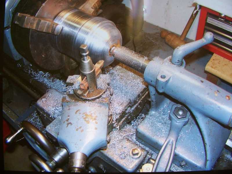

     The machineing was done on a 10"X24" Logan lathe.  I left as much stock on it that I could, for size and I was haveing trouble getting a good cut , due to metal, bit angle, lathe speed, or probably inexperiance.
     I first turned a long shoulder so as to have a good chuck bite.  That would be the trunnion end anyway.  Then contured the barrel, you can see they are shallow cuts.  Next was drilling a 3/4" hole the length of the barrel including the powder chamber which finnished out at 3/4"X 3/4".

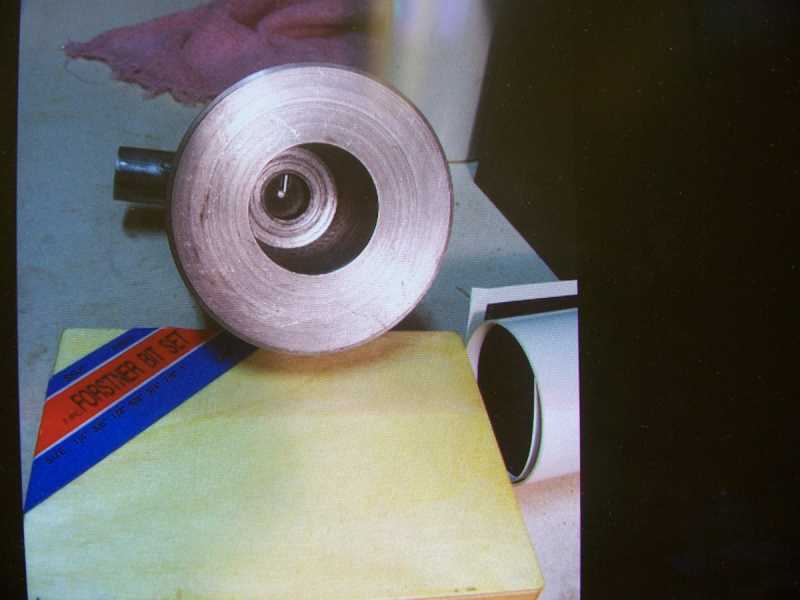

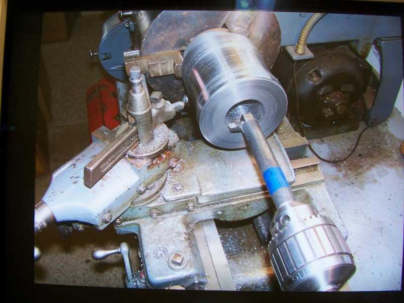

     From here on I have enclosed some pictures.  The first one is of a homemade boreing bar, which is appropriatly named.  I found that I could only get about 3 or 4 thousands cut on each pass.  You can see that the bar isn't attached to the cross feed. so the cutting bit had to be adjusted each time.   ( Boreing)  The bore finnished out at 1.709".
     The next one is of the reversed barrel end being rounded.  That cut was done free hand, and then filed to smooth.
     Here we have one of the buisness end.  Notice that the vent hole could be a little more forward.  Picking the almn foil is a bit tricky.

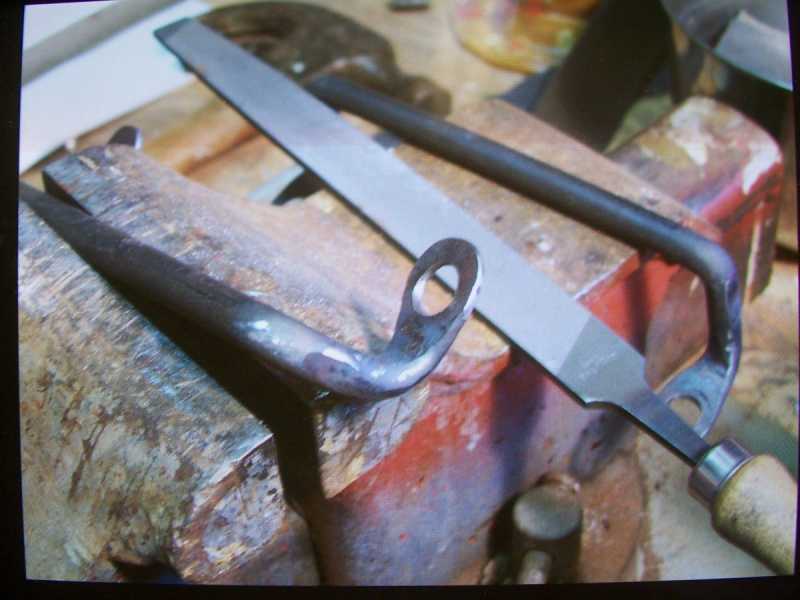

     This is one of cleaning up the handles after being forged and drilled.

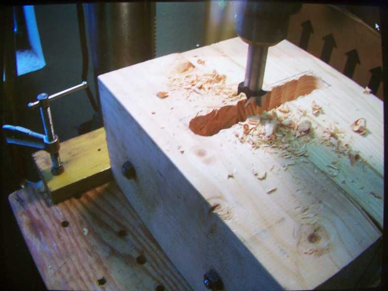

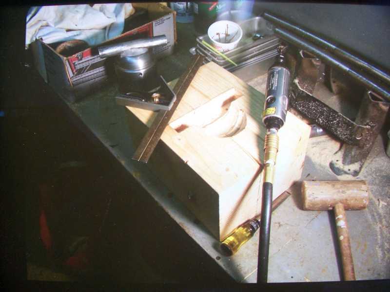

     The next two are of hacking out the furniture.  I inleted the barrel to a stationary 45 deg.

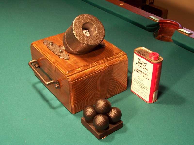

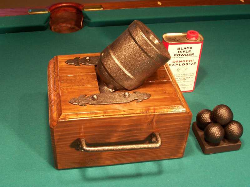

     The last two are the final product.  After antiqueing the barrel  and hardware, a little trick done with graphite and varnish, the wood work was finnished.  I expect there are some improvements that could be made.  It is not scale, it is what I had at hand.
      Cost---- electricty and some varnish.  Shoots good.  About two 45 APC cases of BP, 54 grains, slings a golf ball over 100 yds.
      Note;  cover your furniture with almn foil when shooting.
                    Div Arty
Re: First Mortar
« Reply #7 on: February 06, 2007, 07:28:58 AM »
Looks good.
You don't need to load the powder in foil for a  mortar.  Just por it loose in the chamber.

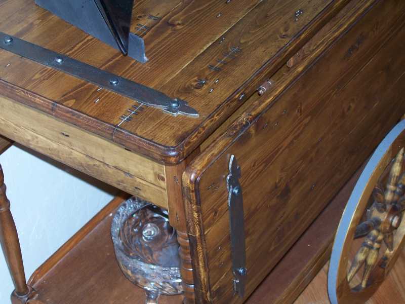

     Rick and Powder keg; If it comes out here is your answer.
     It's a process that turns any hard surface that will hold paint into an old wrought iron finnish.  Like anything else, practice on some scrap first.
     To start, spray your project with flat black paint.  Not heavy, just cover it.  Let Dry.
      Next, give it a coat of varnish.  The heavier the coat the ruffer it will look when finnished.  Watch the runs on any vertical surface.
      While the varnish is still wet, sprinkle with ( Flake ) graphite.  The thicker the varnish, the more graphite will stick and here again the more corroded it will apear.   ( LET DRY ).
      Then, brush off the excess graphite and  BURNISH the finnish to suit your taste.  Finaly, coat it with a gloss or satin varnish.
       Here are some samples of how you can use this technique.
       The first are some straps on a tea trolly.
       Second, is a family crest.  The helmet, eagle and Fleur De Lis were blocks of plaster of paris cast onto the curved shield then removed carved and finnished.  The sword and halberds, no not steel, sugar pine, carved and finnished.  No one has caught on yet.

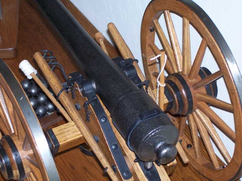

       Last but not least, cannon.   Well, there you have it.       Div Arty
