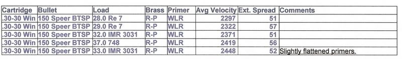

 I was able to get to the range (finally!) and see just what the 150 gr T/C Contender loads would do in my Handi.  It would be interesting to see just how close to 2500 fps I could get, staying within published loads.  This is the first round of tests, only 5 shot strings this time so this is not as thorough as I usually would be, but I just trashed 50 cases since they'd been loaded to the limit several times already and wanted to start with new brass.
 All loads used the Speer 150 gr BTSP, COAL 2.700", R-P brass (new, FL sized), WLR primers.  Load data for 3031 is from the IMR handbook, all other from the Speer manual #13:
 I don't know how well you can read this table since the forum resized it (I tried a few different sizes when I posted it, they all came out the same), but Plain Jane ol' 3031 is winning the velocity war so far.  H335, AA2460 and maybe Varget are next.
                                                                     Rick

If anyone can't read it, just right click the chart and save it, then open the saved file, it's very legible then.
Thanks for the report, Rick!! ;)

Rick A relative and myself have noticed fairly wide spread of velocity from one 30-30 to another in the NEF and H&R line. The older Toppers were even more wide spread. It seems if you get a "tighter chamber" and closer to spec barrel you can attain higher velocity with less powder. We even had a difference of 3 grains or more between rifles. So the old saying that each rifle is a book in itself holds even more true with the handi's and toppers.
Thanks for sharing the chart.
