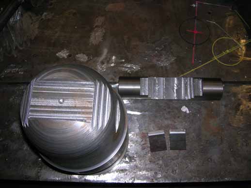

This project hit overdrive this past week.  The mortar was to be used in a reenactment.  I’ve known about the reenactment for a while but it still crept up on me.  The mortar is operational but rather rough.  It did not end up being used in the reenactment.  Since I only had fuse for ignition the safety officer didn’t feel comfortable having it on the field.   A lot can happen while the fuse is burning.  I agreed completely.  He did inspect the gun and help me test fire it.  He though I had a very sound gun and said that it would be a fine piece once I got the finish work completed.
Here are a few more building photos.  I would have had more but I didn’t have the time to take them.

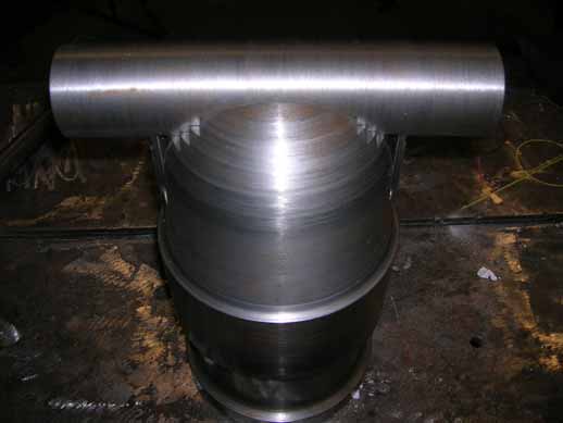

Here are all the parts ready to be welded together.

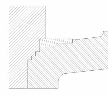

In order to preserve as much wall thickness as possible I came up with a system of steps to fit the trunnion to the breach of the mortar.  I strayed from my original plans due to some dimensional differences but the general design is the same.

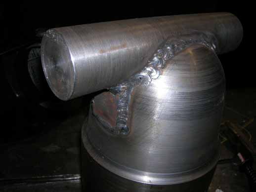

Here are my ugly welds.   A little grinding will smooth everything out.
It doesn’t look too bad.  A little more work and I’ll have a nice mortar.

That looks like a good idea with the trunion. Did you tig or mig? I was wondering if a guy grinds down the weld and then smooths it with body putty if recoil may loosen the putty.  Looks like it is going to be a nice mortar!

The barrel is mig welded.  I would have preferred to use tig but I’m not all that good at it yet.  It takes me a long time to get a good looking weld.

on metal that thick the weld looks awesome.
 I am assuming you have a 200+ amp machine and are running it high, or are you just way better than me?

« Reply #45 on: August 18, 2006, 11:28:43 AM »
The welding was pure skill.  No I used a big miller welder they have at work.

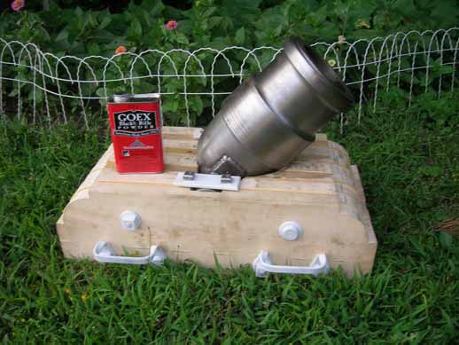

I got to shoot my mortar over the weekend at a Civil War reenactment.  It sounded great with 4 oz of powder.
Here it is with everything painted up.
This was a fun project but I’m glad it is finally finished.
