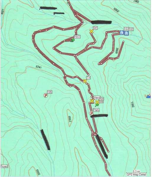

Lets say that during the day he decided to hunt over to my location and I provided him a LAT/LONG and he selected go GoTo.  Now the solid line from his position is going to my position and not Pk1.   After we tie in we plan a hunt that will have us back at the pickup in a few hours.  The plan is to meet back at the rig at dark.  He selects the FIND button, and selects the Waypoint Icon; he gets a page showing all symbols (Waypoints) near his current location.  From that list he selects Pk1 pushes ENTER, and he selects GoTo, which sets him up to navigate back to the pickup.  He might select the Trip Computer Page, which will feed him the data so that he is not a mile or so from the pickup come sundown.
Before he is given the unit I have selected the MAIN MENU page.  On that page I selected TRACKS ICON, and I have the Track Log on.  This will show his trail on the Map Page, and if we need to he can track back.  At the end of the day we can save or clear the track he has created.  And clear the Trip Computer Page so that we can start fresh the next day.  I believe there is a benefit to examining your TRACKS.  It gives me a better feel for the area.  And you can save and print out the TRACK months later to refresh the memory.
