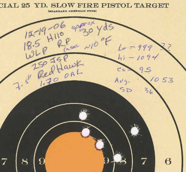

A) 18.5 gr H110, Win Large Pistol Primer, R-P brass 250 JSP Outlaw, 1.70 OAL loaded length, Lee Factory Crimp
REDHAWK: 5 shots low 999 (??? debris?) hi 1094, ES 95, Avg. 1053, SD 36 , 30 yd group approx. 2 inch ctc

NOTE I wrote the SD wrong on the target.  That one high shot could be the really slow one but I sure couldn't detect and different feel to the shot.  Was it junk not stopped by the blast baffle? Weird brass, erratic crimp, temperature?  I might have to watch my cylinder to see if I have one that gives a significantly different velocity.  That low velocity shot was not the first in the string, in fact the low readings in both H110 tests were the 3r or last – can’t remember. Maybe the bullets walked out of the crimp.
I wonder too if I should be careful and work up in less than .5 grain increments in case I'm pushing max levels.  Don't recall how temperature sensitive H110 is.  I thought it was supposed to be pretty good compared to old Win 630 etc.  The cold makes everything a lot harder to do.

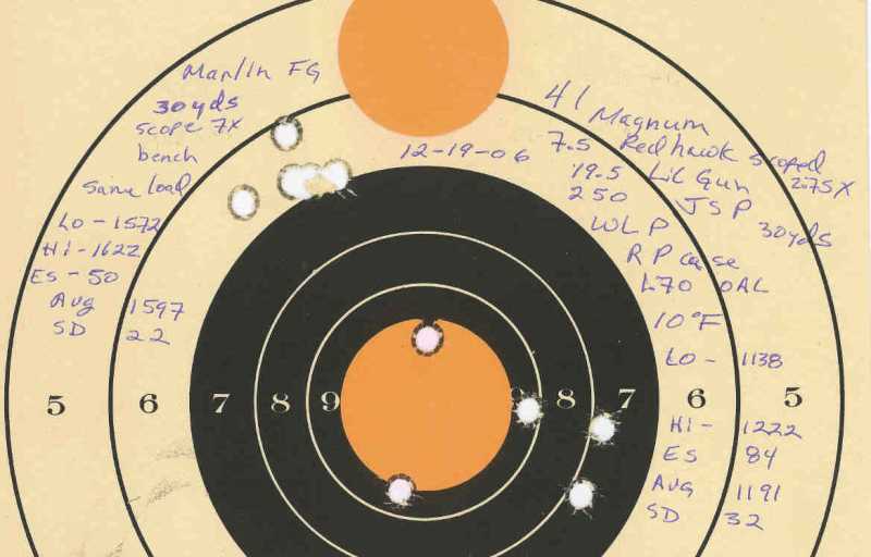

C) 19.5 gr Lil Gun, Win Large Pistol Primer, R-P brass 250 JSP Outlaw, 1.70 OAL loaded length, Lee Factory Crimp
REDHAWK: 5 shots low 1138, hi 1222, ES 84, Avg. 1191, SD 32 , 30 yd group approx. 2.5 inch ctc
MARLIN FG: 5 shots low 1572, hi 1622, ES 50, Avg. 1597, SD 22 , 30 yd group approx. 1.2 inch ctc accurate feeds very well in my gun.
This load recoiled much more emphatically than lighter loads in the Redhawk.
I'm pleased with the Marlin and REALLY pleased how well it cycles even the long seated rounds.

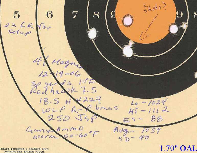

E) 18.5 gr H4227, Win Large Pistol Primer, R-P brass 250 JSP Outlaw, 1.70 OAL loaded length, Lee Factory Crimp
REDHAWK: 5 shots low 1042, hi 1112, ES 88, Avg. 1059, SD 40 , 30 yd group approx. 2.75 inch ctc
I think 2 shots may have passed thru one hole? I don't think one shot went to wild unless from a clean bore. Mild.
First string in test, so ammo and gun, even chronograph were pretty warm from being in the car.
.22 holes in target were shots to test chrono setup. I have to try the laser pointer trick I read about on GB.
