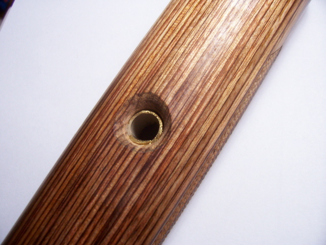

I quit using the washer and cut some .40 S&W brass to length. Drilled the forarm hole out to 7/16ths. Then glued the brass in place with just enough sticking out the top to hold the stock away from the barrel. Where the washer used to sit I filled with JB Weld. This gives a good solid metal on metal connection. My groups are consistant on both the 500 S&W and the ultra 25 06.

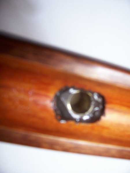

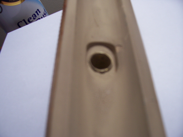

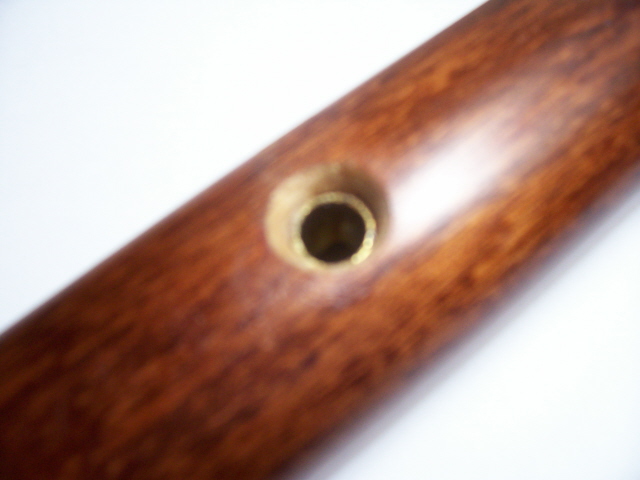

Please bare with me while I learn how to post pics. This should be two pics of the ultra with the brass sleeve glued in place without the JB Weld. The other two are of the handi fore arm with JB Weld on the inside where the washer used to be. This gives just a little space between the barrel and the stock I didn't even have to sand the stock. It does position the stock down slightly so in the future I may do some sanding and readjust. The reason I went with JB Weld is because the handi 500 came loose after some heavy loads at the range. No problems since the JB Weld was added. I have not added JB to the Ultra yet but it had no problems at the range.

Nice work!! I fixed the links so the pics show in the post. ;)
