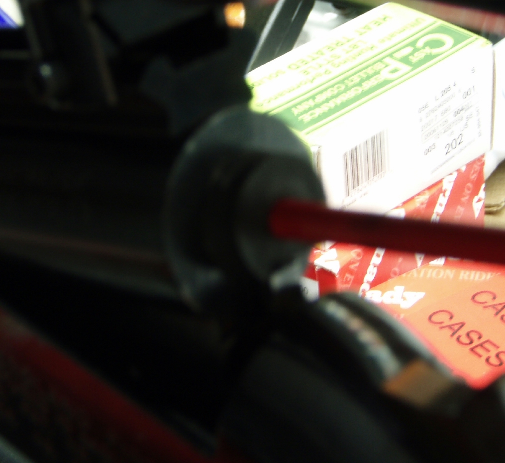

Here's an out of focus pic of the Kleenbore rod with nylon guide in the chamber, I cut a third off one side so it will fit on top of the ejector/extractor when the barrel is all the way open, if you don't the rod won't be centered which isn't a problem with a large bore, but on the smaller bores, the rod might rub the top of the throat/neck area.
