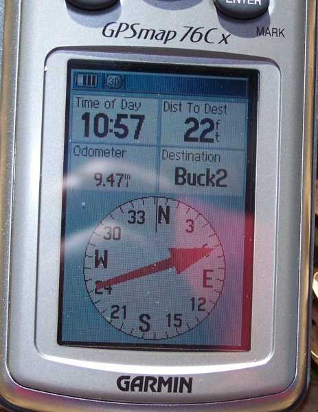

A lot of times I will use the Pointer/Compass page as I am closing in on a waypoint.  Note the Dist to Dest box in the upper right corner of the screen.  By following the pointer and watching the numbers decrease in the Dist to Dest box I will close in on a waypoint.   ::)BUT I have seen the Dist to Dest number change when I am stationary.

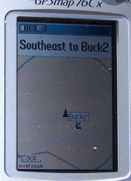

Another method is when a user gets up close is to switch to the Map Page.  The Bucks head is the waypoint and the black pointer is the user.  I also have the unit in track mode if I am looking for a small object.  I will walk towards the waypoint until the pointer is on top of it.

tucoblue:  The new satellites have made your older unit better.  You also got me playing around with my gps units.  From my testing today I feel that the signal is strong but I am getting mixed results when it comes to accuracy.  This time I created two waypoints, 115 on one gps unit and 120 on the other unit.  The location(s) are within a foot of each other.
At this point the Pointer can be corrected by walk around in a circle for a minute to get it pointed the correct direction.  The Pointer on the right is correct.  The difference was cause by my movements when setting up the photograph.
The trip Odem on both units is correct.  I had not cleared the one on the right after hiking.
Dist to Dest is incorrect on both units.  This bugs me because normally this is reliable.  Are Air Force guys playing with the satellites today?  They could be, the software in the satellites have been modified.  WAAS is activated on both units.
The Cx unit on the right is receiving more satellites.  The Elevation unit on these units is produced by satellite signals, and not an altimeter.
As I explain earlier the user needs to follow the black pointer to his location.
Before jumping to conclusions on this one study the compass rose.  There is only a few degrees difference and this was a result of my moving around and placing the units.  The big difference is the Nine feet difference in Dist to Dest.
I believe tucoblue has hit upon what is happening with gps satellite signals.
**Accuracy in these photos was reduced because the gps units were operating under heavy cover.

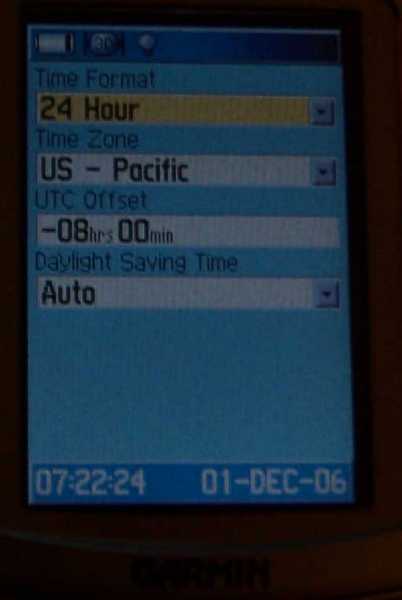

While we're here I may as well ask another question (Or two). The elavation value seems to never settle. It's always moving up or down. Is this a normal phenomenon? I've never paid much attention to it but would like know what's going on. I assume the clock is tied to the Fort Collins atomic clock since the unit knows the time in any time zone and adjusts itself for daylight savings time, etc. True?
Many Thanks....

Garmin time setting:  I believe that Garmin units follow this format with most of its outdoor gps units.  <Main Menu>Setup>Time>Time Setup>.  At this time the user can chose a number of options.  I always choose 24-hour time, in my case US-Pacific, and set Daylight Savings time on Automatic.
I gave my son the eTrex Legend so I cannot consult it, but I recall changing the factory default from the land of OZ time (Central Time) to Pacific Time.  Garmin’s US headquarters are in Kansas, which is in the Central Time Zone.  Users in other times zones may want to check the setting on their unit.  You need a least 4 satellites to receive accurate time.  It is my assumption that other functions of the gps are affected if it is setup for the wrong time zone.  The satellite clock is far more accurate then the low cost clock in our gps.
I always thought the time was set by the Atomic Clock at the U.S. Navy observatory, but I am not sure.  http://tycho.usno.navy.mil/what.html
