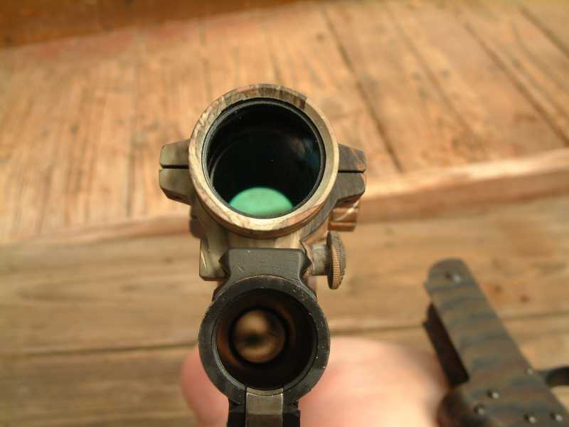

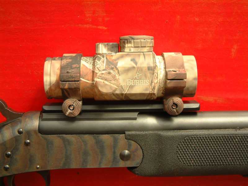

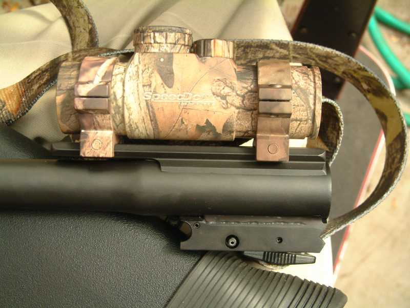

Here are some pics of the mount I had custom-machined and silver-soldered on my 12 ga choke tube barrel.

Looks great, nice and low!!

Very nice, gh!
Looks like a solid setup for gobblers and deer. It would be nice if we could get that type of a setup from the factory on at least one 12 ga barrel with choke tubes. Who made the original mount? Looks like one that was made for an Encore.

« Reply #11 on: December 24, 2006, 12:17:33 PM »
Thanks for the compliments, guys. I've been quite pleased with it, myself, even though it cost $160 total, including a reblue job, which was a good bit higher than my gunsmith's original estimate. (That does not include the barrel and red dot sight.) My gunsmith had the mount custom-machined by his CNC guy. I don't know if he started out with steel bar stock or a piece of steel Weaver stock, but it's worked great so far. The barrel shot about a foot left and a foot low when I patterned it. Now it's a 50-yard turkey killer with #6 Hevi Shot and a Briley Hevi-Shot choke tube.
I bet you could have NEF install some of their sights from the Tracker II or Huntsman barrels, if you sweet-talked them. I know they'll install adjustable sights on some barrels that don't have them as standard equipment. You could probably also use an Encore mount, with maybe a little fitting. I just wanted something a little different, and ended up paying quite a bit for it.
