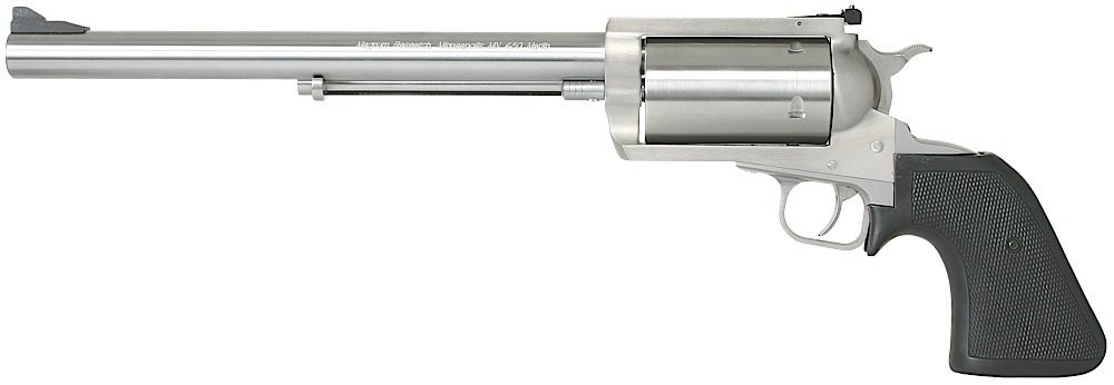

But wait a minute, FA does already have a 45-70, which BTW can be had for $756.39 http://www.budsgunshop.com/catalog/index.php/cPath/21_38

Sorry to bust your bubble but that is a Magnum Research BFR 45-70 a not a Freedom Arms.

Dang Redhawk1 my bad there.....  ;D your right.  BUT the Magnum Research BFR 45-70 would work though.

Yeah I have seen that hand cannon from Magnum Research! No other way to describe it. Not sure what I would ever do with it or if I have the strength to handle it.
