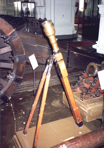

Hi,folks. found a picture in the links for pre-1898 cannons that shows a mortar on a bipod predating the stokes by nearly 200 years.was the patent for the stokes about the way it fired-by dropping the round onto a fixed firing pin or the basic design? Reason I'm asking is the recent posts about legality of the mortars on legs.Just curious what ya'll think. The picture is of a russian antique mortar with legs.Badger Bob

It's not the issue of drop by firing, since we use ignition by fuse/percussion after loading, it is the legal wording of what is allowed by law, namely 'replica of' or original designed/built in 1898 or before.
Stokes got the idea from watching something fall and saw something in construction with supporting legs and put the two together - in about 1914.
So the real issue is whether there is another similar use of the concept of two supporting legs being used before 1899.
Try again on the pix - my confuser didn't bring up a picture or even the little red X.  Also include a URL for background info - it'd really help to verify the information.

I wonder if it was ever fired.  The leg behind the barrel seems awfully spindly to resist recoil.
Russian 6-funt bronze mortar Model of 1707
A "funt" is an old Russian unit of weight equal to .903 lbs so a 6 "funter" would be roughly equivalent to a 5 1/2 pounder (about 3.35" diameter.)

I think the recoil would be ok - it would act to compress the main post under the bronze tube - maybe driving it into the ground a bit, but it should be strong enough.

looks like that could be the full scale version of the contest winner,or at least one where you wouldn't have to get all the way down there to load it.

Looks like a Handgonne ona tripod...

That mortar is in the Russian Army Artillery Museum and had little in common  with a Stokes.   It appeared to be more and over sized hand gonne sitting on tripod.

I was looking at it from the perspective of a touch hole fired mortar supported by a bipod.  Obviously it didn't use dropped shells the way a Stokes does.  I think it could be used as a citation of pre-1898 art in a discussion with the ATF.

The Model 1707 was a short squat mortar tube that sat upon a tripod.
The Stokes is a long tube that sits on a base on the ground.  The long tube has legs to hold the tube upright.  The mount that attaches the legs to the tube controls elevation and windage.
The trick is to convince ATF that the two are the same.
